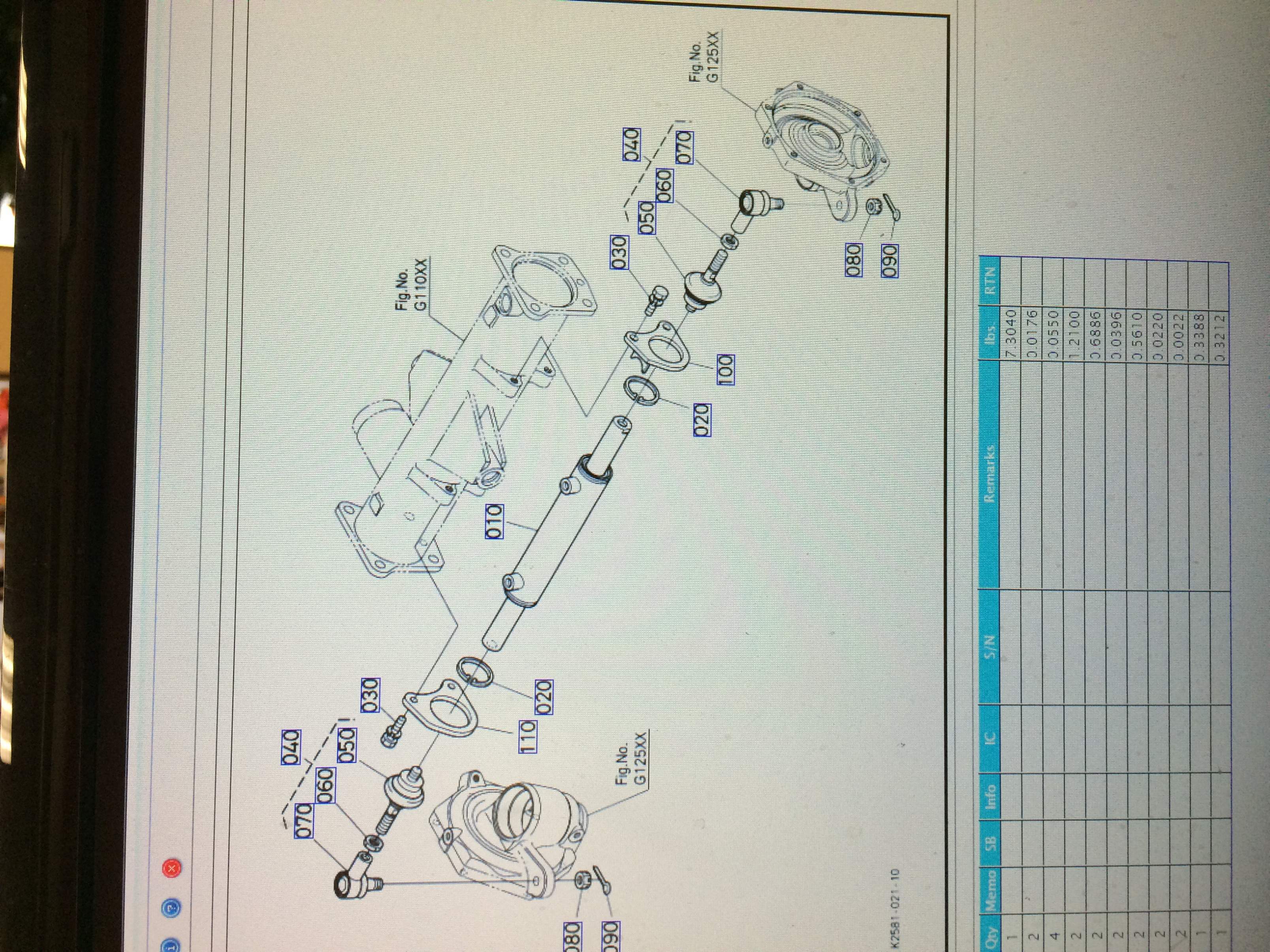

Developed a slow leak at the right front hydraulic steering (not sure correct term) seal, this is the cylinder that is attached to the tie rod (make sense?). Approx 3 tablespoons leaked out in 7 days, not much, and would just leave it, but the tractor lives in the garage.
Have any of you guys changed this out? How hard is it?

What is the basic process? Does the tie rod end screw off? The process wasn't 1005 obvious to me, I didnt know if the cylinder would turn or if I could just put a wrench on the tie rod side and unscrew it...

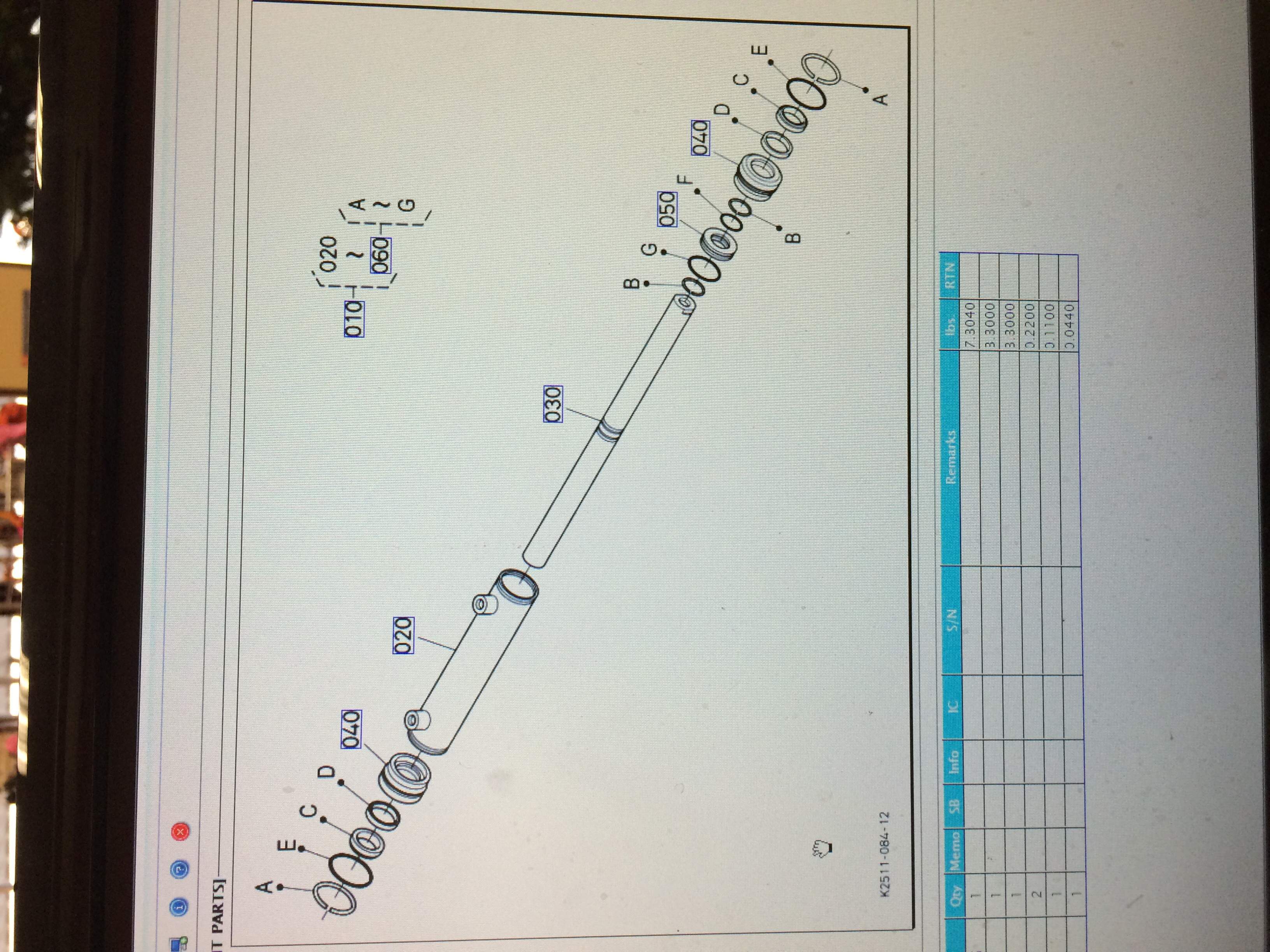

As someone who is getting ready to do this, I would point out it is important to understand WHY you seals are leaking. Most likely you have a rough spot on the cylinder somewhere. If you are replacing the seals without fixing the root cause, you will be doing this again soon.
The tech at Messicks told me to use high quality emory cloth to smooth out any nicks or scratches in the hydraulic cylinder before putting the seal kit in.

For today, the simple solution has been a bowl under the offending seal when parked. The leak is VERY slight, maybe a teaspoon a week or less.
But yes, that is a good point to check to see what caused it. I checked the cylinder pretty closely, didnt see any imperfections, but will look again.
