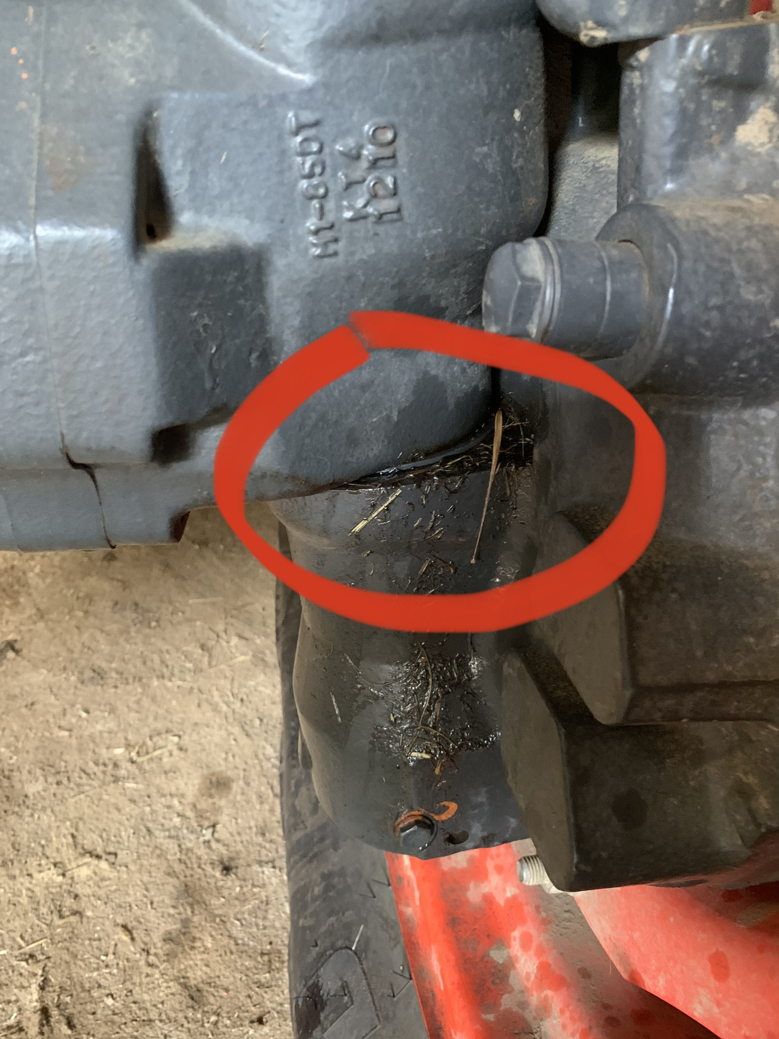

My 2003 L3430 4wd leaks a bit of 80/90 at the turning joint for the right wheel, not the left. Enough leaks to wet the inside of the tire a bit but not a lot. I jacked the front end up and shook the wheel and the joint has only the slightest detectable play. Checked fluid level and it only needed 1/2 quart.
Seems like a simple leaky seal. Have you seen this before on these models? Is the seal hard to replace? Think it's minor and can be ignored?
The left does leak just enough to wet the surrounding metal and collect dirt.
Thanks for thoughts.

It’s a faulty seal. I have replaced 3 of them on my Kubotas. I find it usually happens with a lot of heavy loader work, but that’s just speculation. A leaky seal won’t really hurt anything unless you immerse the leaky area under water (if oil can leak out, water can leak in). If you get water in the bevel axle case, that could be bad.
Otherwise you’re not hurting anything, but you have to keep checking the axle oil level. You don’t want to run it dry.
It’s repairable with decent level of mechanical ability. Take A look at your bearings while you’re in there.

Does it look like this?
You have plenty of time to fix it. Just remember it could turn into a "gusher" at some point and you could lose oil faster. I suggest a daily inspection.

Ive replaced quite a few of those seals as well as the bearings. Its not just a usual failure, its practically inevitable in my experience. They arent hard to replace and dont require any special tools other than a good set of snap ring pliers. The biggest thing is to keep everything spotlessly clean when you start pulling things apart. the bores that the bearings sit in have pretty tight tolerances so if you get even a single grain of sand stuck between the bearing and the bore it wont want to go back together. from what ive heard and seen personally, the usual cause of those leaking is moisture causing a little rust against the seal surface causing the seal to wear out along with dirt. When you fill the fluid back up, expect it to take quite a while to work its way through all the bearings so give it plenty of time before you check it and top it off the final time. In some cases, a seeping seal can be a sign of bearings starting to fail so have a good look at the fluid when you drain it to make sure its not shiny.

I had one side with a failed bearing, too. The other side had a perfectly good bearing.

It's one of those jobs that needs photos, an absolutely clean place to lay out the parts, and be sure to keep all the shims in the right order. A few notes wouldn't hurt.
Like Hay Dude says , I also wouldn't replace a bearing just to do so. Check them out.
I also don't mind putting up with a small leak for a long time and just check the oil in the axle daily instead of replacing the seal. It's a job you can schedule for convenience.
If you do replace a bearing, do not be tempted to replace an open face bearing with a sealed bearing. They need to be open for oil to flow through.
If the shims stay in order it is not a hard job. It is a moderately fussy job, but clean work and kinda fun to see all those shiny surfaces. You can do a lot of it sitting down.

All the above plus you need to have a look-see at the king pin and king pin bushings, especially if you do a lot of loader work. Easy to replace as well. drive them out with a suitable sized drift and drive the new ones in.
For some reason (I suspect manufacturing cost), Kubota likes to use ball bearings in the outboards instead of Tapered rollers which do0a lot better job of bearing the weight imposed by a front end loader, because tapered rollers distribute the weight a lot better and have a wider contact point than ball bearings.
If you king pin bushings get worn, that will cause the radial seal to leak as well. Just replaced the left side on my 6000 hour M9. Easy to tell too. Loft the front end, taske the wheel off and grasp the outer flange and try to move it vertically. If it moves at all it can be the bushings, or the king pin or both. Good time to check the front axle pivot too for excessive slop. It needs to move free in an arc with no lateral movement. Owners tend to forget about greasing the pivot and checking the pre load. Your owners manual details how to set it using the front bolt and jam nut.
