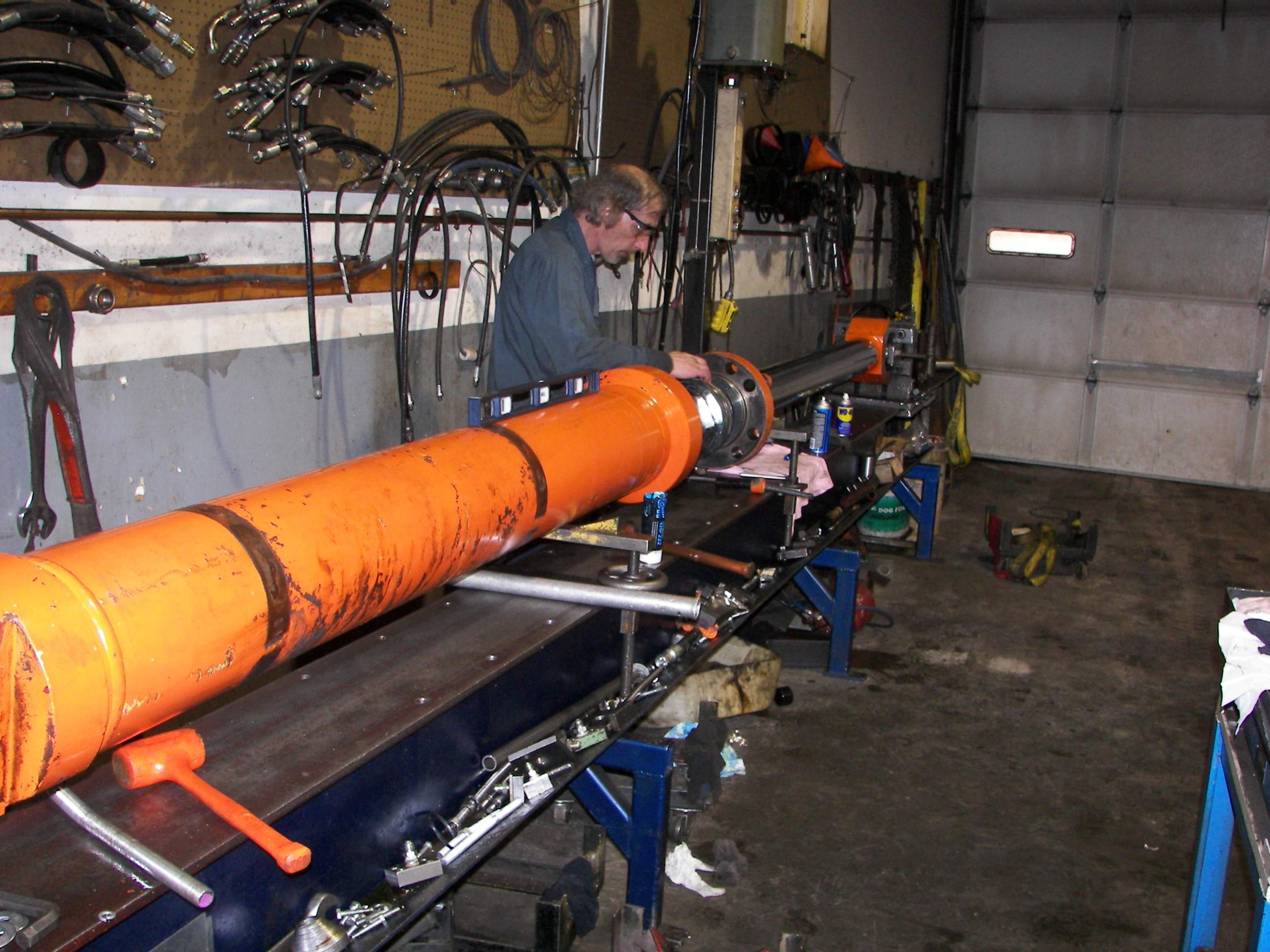

Glad it worked out for you racerboy, but I have to side with Rocwin & KW......this can be BIG trouble if it doesn't just come apart.....
Many parts have to be remade if proper procedures are not followed by doing things carefully.......if done carefully you have plenty of time to heat/cool and decide what to cut or machine before it's all junk.....I've had many jobs come in that took more work/money to fix messes from poor dis-assembly than if it had just been dropped off for us to do the work.......:confused2:

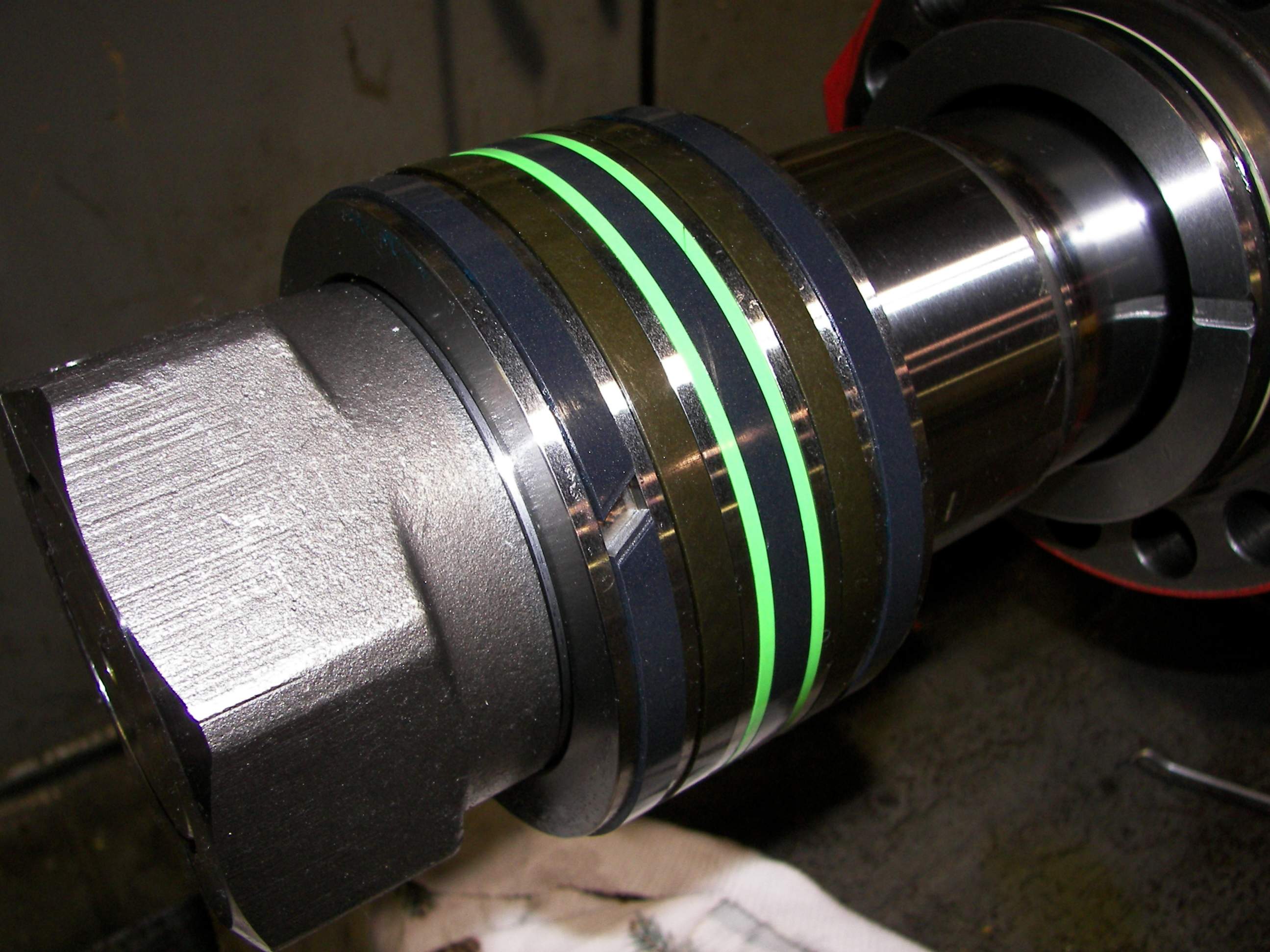

At work we take pride in our work not to just put the boots to it......using a big lathe doesn't give you the finesse of a cylinder tear/down bench......ours can go over 30,000 ft/lbs without any damage to the machine and it gives readings of torque.....
Remember this: "If it doesn't come apart right, It'll never go back together right"
