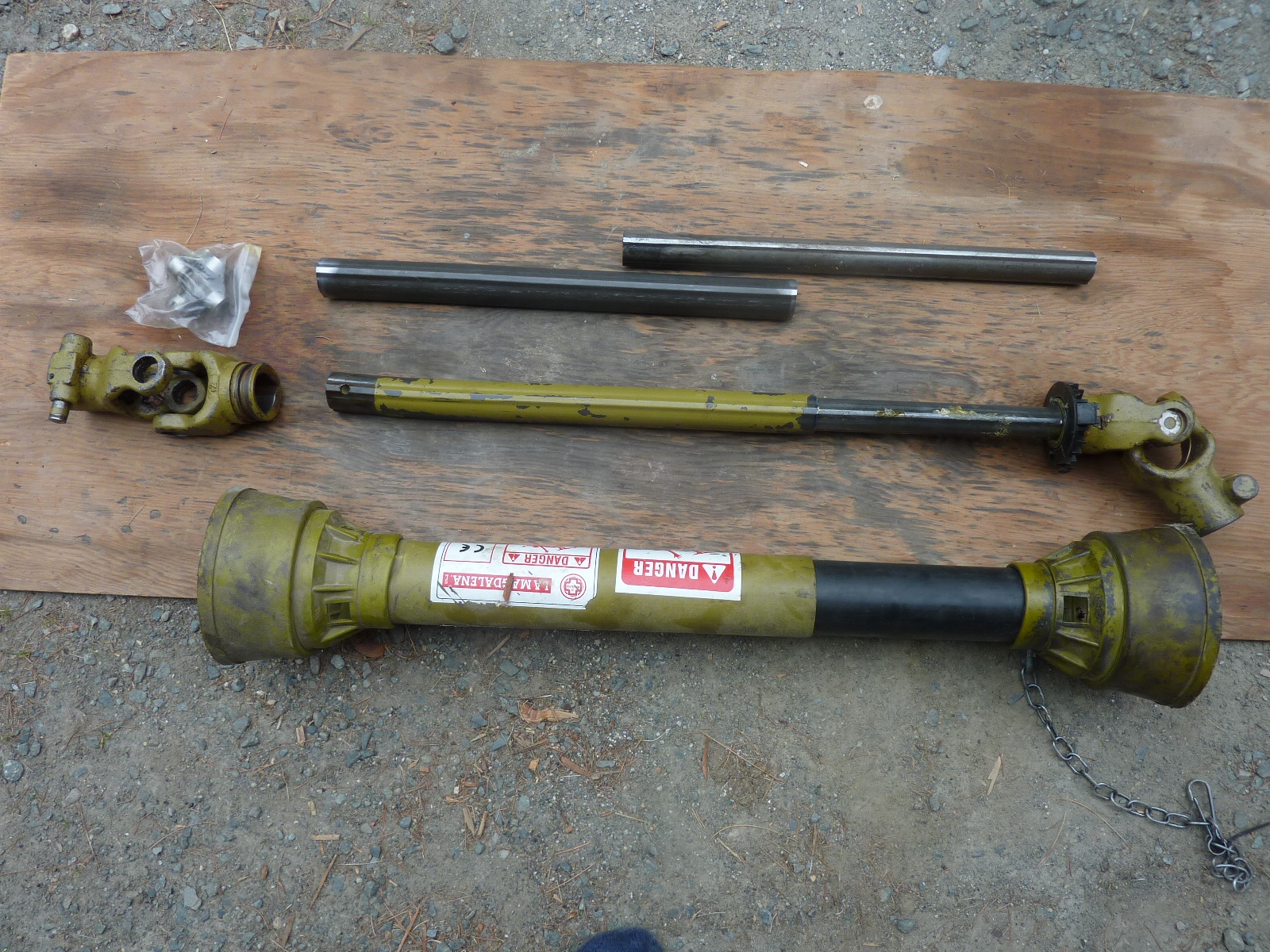

Last week I took off my winch and left it standing in the woods while I graded the road. When I came back the winch had flopped over forward (must have been the wind :laughing:) and the pto shaft was sticking out from under it looking like a broken leg. The U-joint was jammed onto the winch shaft hard and I had to disassemble the U-joint cross so that I could use a hub puller to get it off. In the process I lost some cross needle bearings in the woods. I found that the outer tube of the pto was bent right at the U-joint. Maybe you can see it
So I placed an order for an outer tube and a cross for a La Magdalena M1 PTO shaft. (By phone and talked to a real person.) In pic just above disassembled old shaft. When I got the new outer tube It would not go onto my original inner tube. I could see that it would never slide on. It was way more than just tight. I then assumed that my inner tube must be damaged. So I called to place an order for an inner tube. (Talked to the same nice lady and she remembered me and I told her my story.) She shipped me a new inner tube right away. (On top in pic).
When I got the new inner tube today it WOULD NOT slide into the new outer tube. So I called the nice lady again and told her my story. She said "Oh you can't put any two tubes together you have to find a matching pair. They have code numbers." :confused2: Then she continued, "You have already spent more on those two orders ($90) than the cost of a complete new M1 shaft" ($89). Yikes :confused2::confused2::confused2:. "How about if I send you a complete new shaft and a return authorization for the two orders you placed". That's a deal I said-Thank you.
