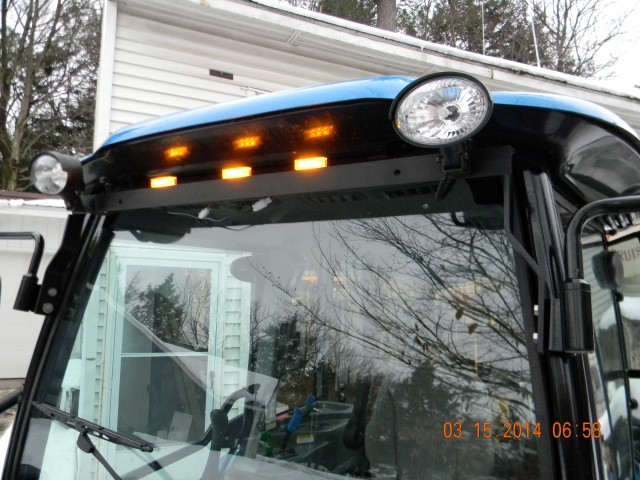

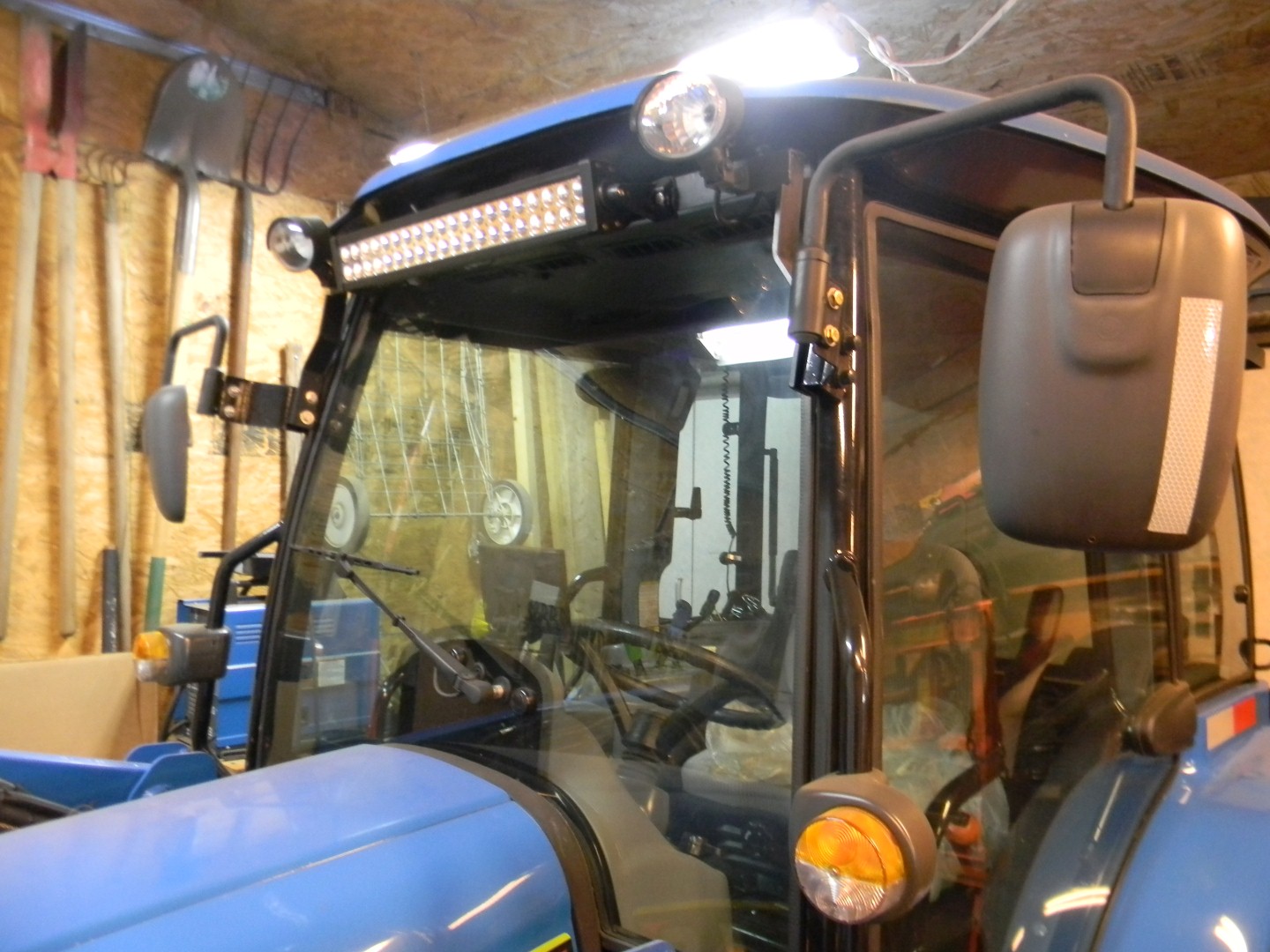

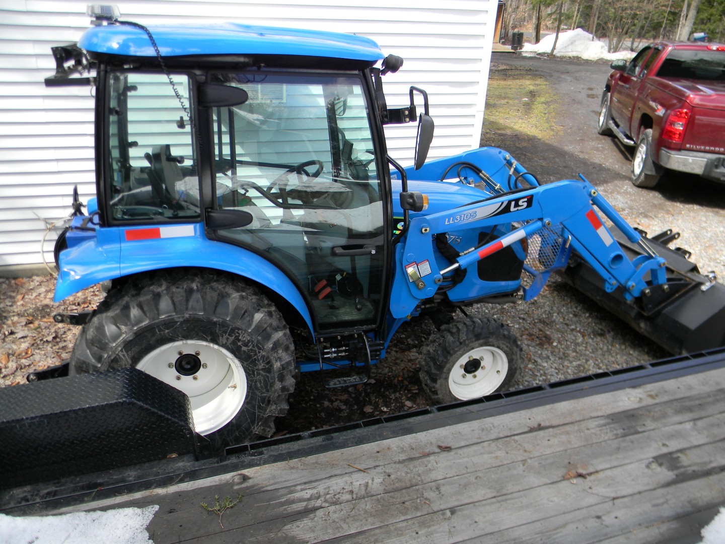

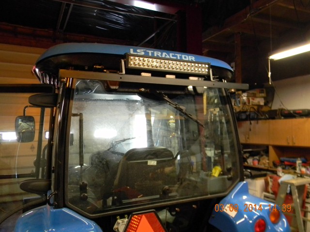

I have not swapped them but have added LED light bars F&R. I made brackets mounted to the mirror mount arms to hold them. Also added flashing strobes F&R and an LED electronic strobe on top. Reflective tape added to the sides too. I like to be seen at night, dusk, or dawn.

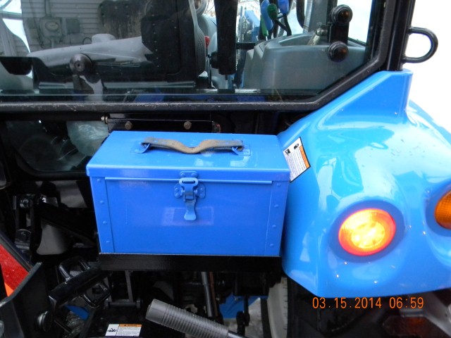

Added a tool box on the back.

Looking good!
That toolbox is Sail Blue isn't it?
   / LED Light Bar? #5
Looking good!
Yes, its sail blue. All I could find at the time. Slightly darker than LS blue.
