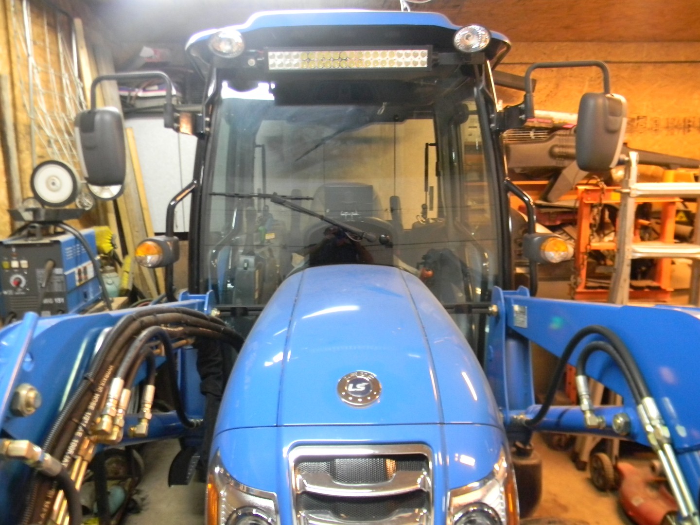

Agreed with the two posts above. Pay close attention to the “flood” and “spot” functions. I have a combination front LED bar that is light years (pun intended) better than the factory lighting. In the rear, I’m only running a small LED flood light and it’s more than enough light IMO.
   / LED Light Bar
Do you know what model light bar you have?
   / LED Light Bar #7
My light bar is several years old and not available on Amazon anymore. It’s a 26” flood/spot combo. I just bought a Nilight kit that contained a 26” bar (that I gave to my neighbor) and two 18w flood Pods. I ended up only using one of the pods for the rear. Will save the other for something else of if this one fails.
