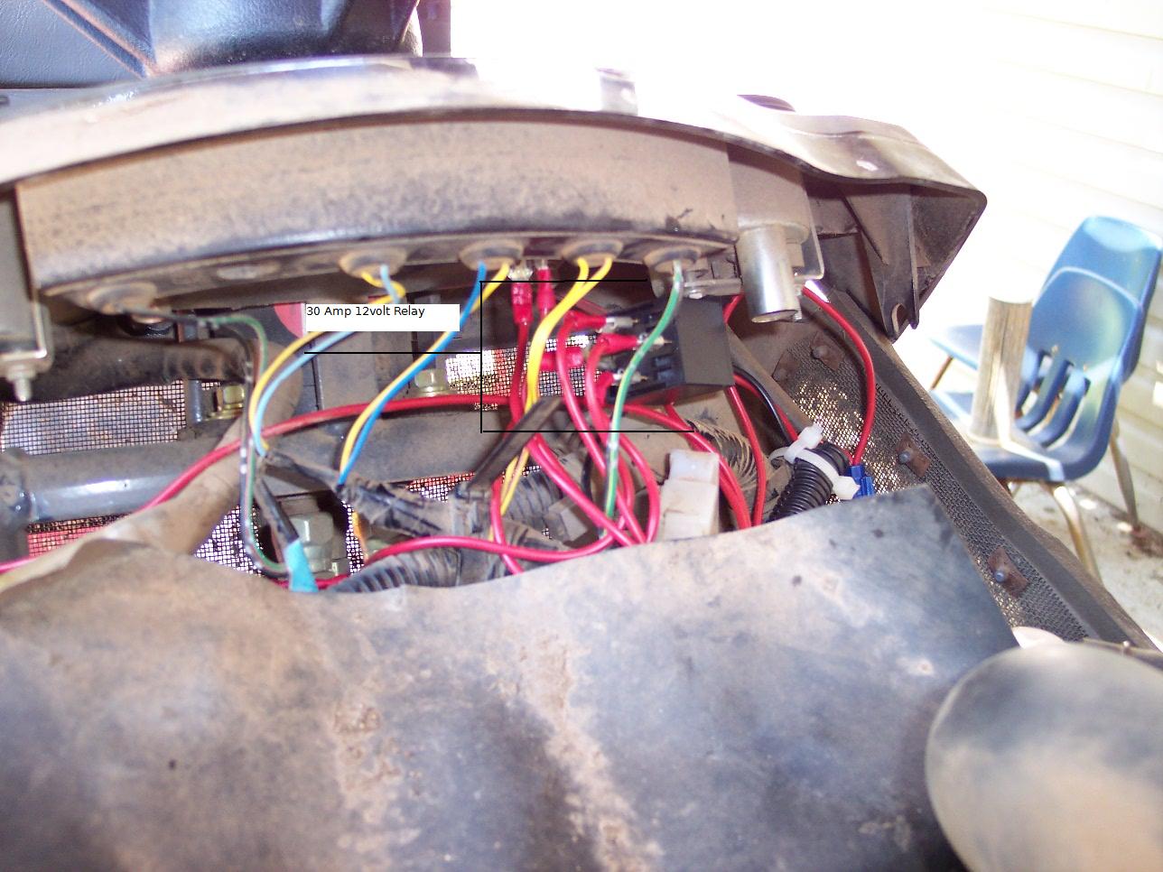

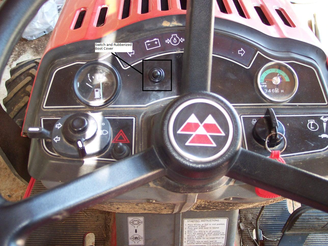

I installed a 30 amp 12 volt relay (Auto Zone) $6.00, this is mounted to the bottom of the fuel gauge? 12 volt 15 amp marine grade switch (Overtons) $7.00, this is mounted on the dash, I found a place were a switch could be added? Rubberized boot for the switch (Overtons) $1.50, mounted over the switch for weather proofing? 54 led light (Northern Tools) $40.00 each, I used the top bolt of the brush guard for the mounting bolt for the lights. It took me and my son about 3.5 hours to complete.
I had some miscellaneous expenses but not much say another $20.00. So my total is around $115.00.
I wired the new lights to work independently of the OEM lights. So you can run the OEM lights or the LED lights or both. I wired it to the ignition switch, so no need to worry about leaving the lights on and draining your battery, and with the low amp draw of LEDs no need to worry about over taxing your alternator.

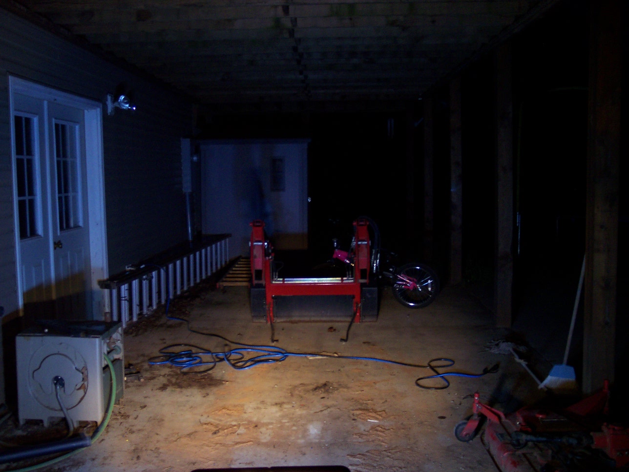

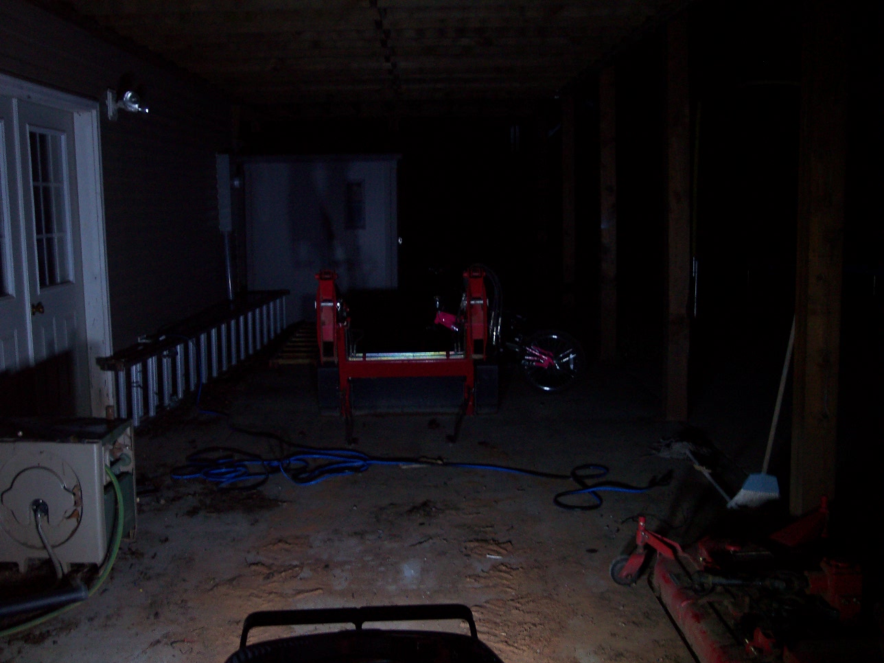

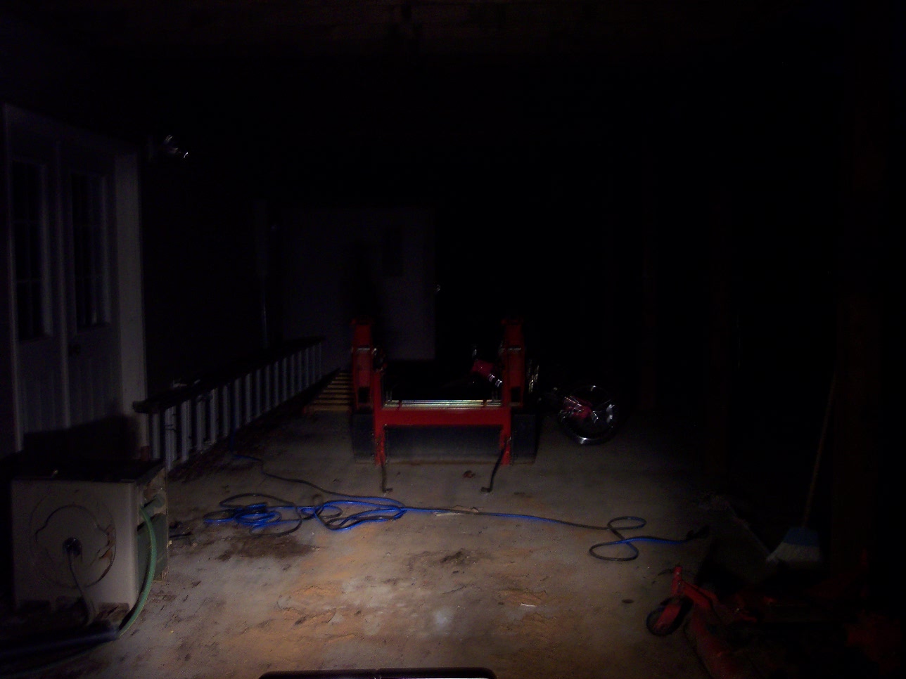

We can see by the pictures the difference with OEM lights, LED lights and both.
In the pictures you see a 32ft extension ladder (16 ft collapsed) there is a small shed about a foot past this. With just the OEM you can hardly see the end of the ladder, with the LEDs you can plainly see the shed past the ladder plus the field of view is a lot wider!

... I have installed them lower than the OEM lights in hopes that this winter when I am pushing snow I will be able to see!
Hope that works for you. Only problem is, LED's don't produce heat. The snow may stick to them and build up until you can't see with them. Hope this is not a problem for you, but I thought I should caution you about this ahead of time. Others on this forum have run into that problem with LED lights.
Since I live in Florida - snow is not an issue :)
thanks for the info and link
   / LED Lights on my GC2300 #7
Actually, the ones used for lighting produce quite a bit of heat as they're driven pretty hard. However, they're usually mounted to a heatsink which dumps it all out the back of the unit.

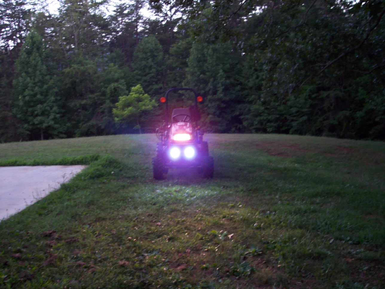

Very nice! Only thing I would have done differnt is mout the lights on the ROPS; I think you would find that far more effective.:thumbsup: Your placement certainly works good for driving but the overhead offers the advantage of illuminating the operator platform, step, and the terrain beside you. Makes is easier/safer to mount/dismount the tractor. You could also add one or two facing backwards. :cool:

The OEM lights just don't seem to cut it.
* If you have the FEL attached and you are driving on the road the height of the FEL obstructs the OEM lights perfectly.
Dan
*I don't see how this would help any?
Won't the Fel still block the lites when when you reinstall it?
   / LED Lights on my GC2300 #10
I'll second that... I like the lights, but IMHO I think the lights would be more useful if mounted higher then the OEM mounted lights...
