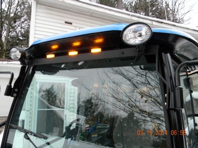

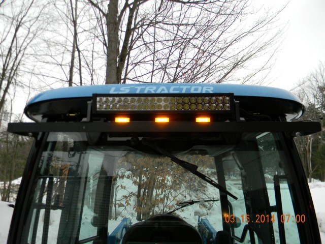

The light bar I used was (120W 24" LED Alloy Spot Flood Combo Work Bar Diving Light SUV | eBay) it was inexpensive and works great. One of the things you may consider and probably haven't run into yet is to build a frame for your work lights. they are only mounted to the front though the fiberglass shell and are not attached to any framework-I snagged a small branch and broke one of the lights off. there are two tabs by the mirrors and I made a frame to mount my work lights and also my new light bar to it. Lightbar.jpgI mounted my backup camera in the front grill and routed the wiring though the hood along the original headlight wires.

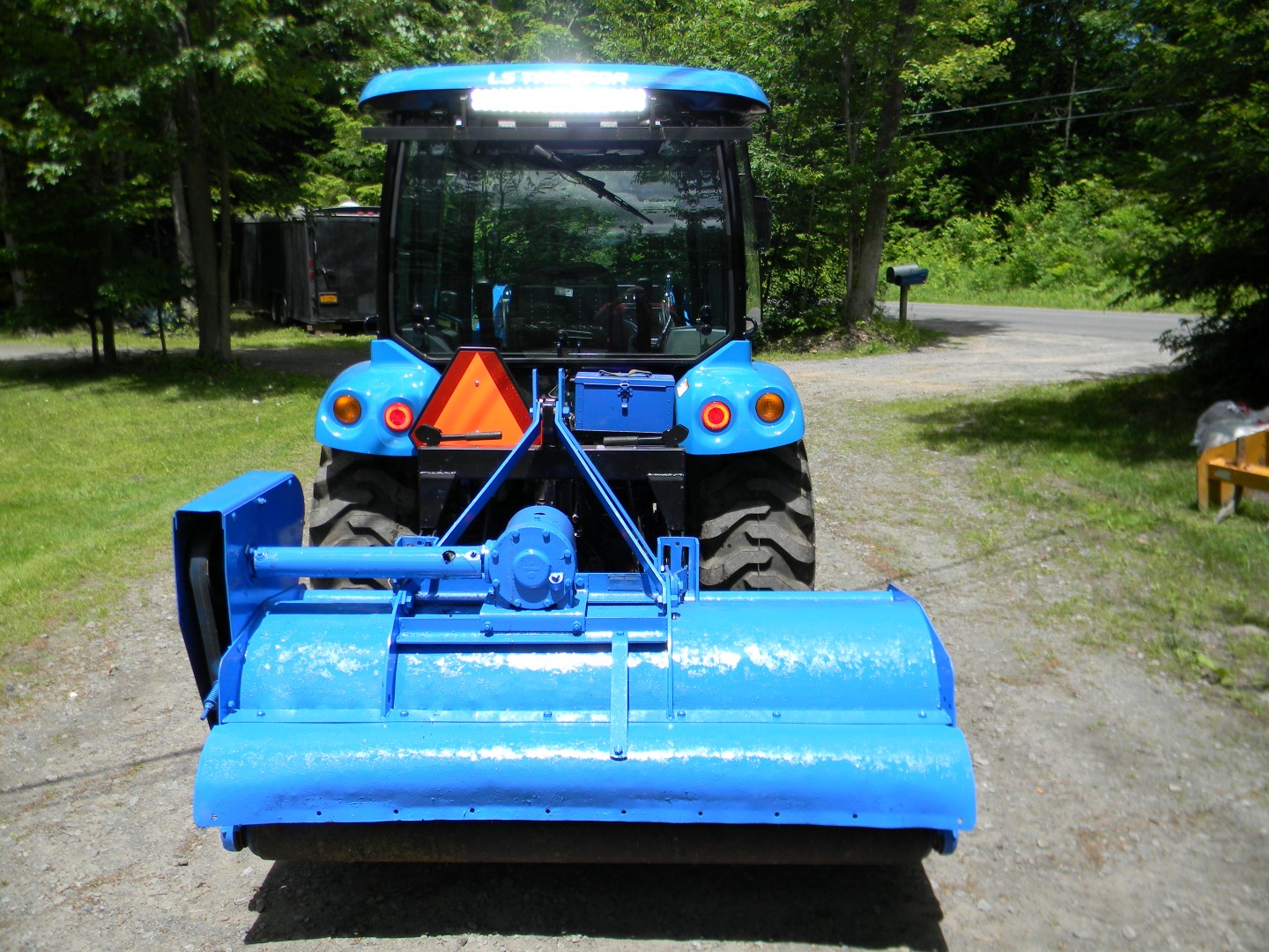

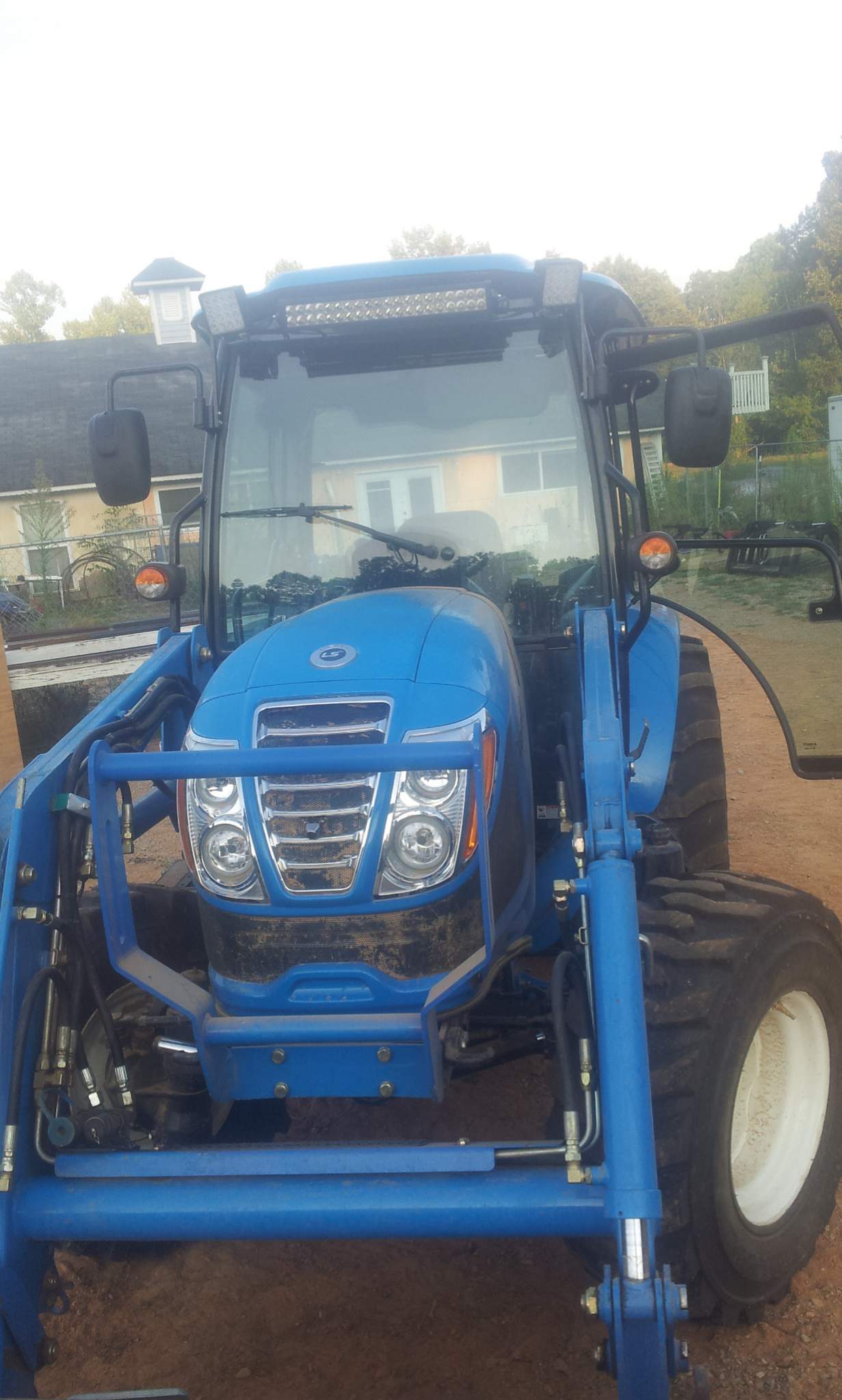

I also made my own light brackets (Front and Rear) after I read whispering oaks busted off one of his lights. I have the same LED Spot / flood light on the rear and moved the existing front cab lights and strobes to the new front bar.
