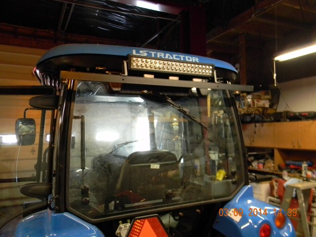

I put 2 on mine. 1 front and 1 back on brackets I made. I bought mine off Ebay from different place. If I recall they were around $50-60 each and free shipping.
I see lots of them now for $34-60 with free shipping.

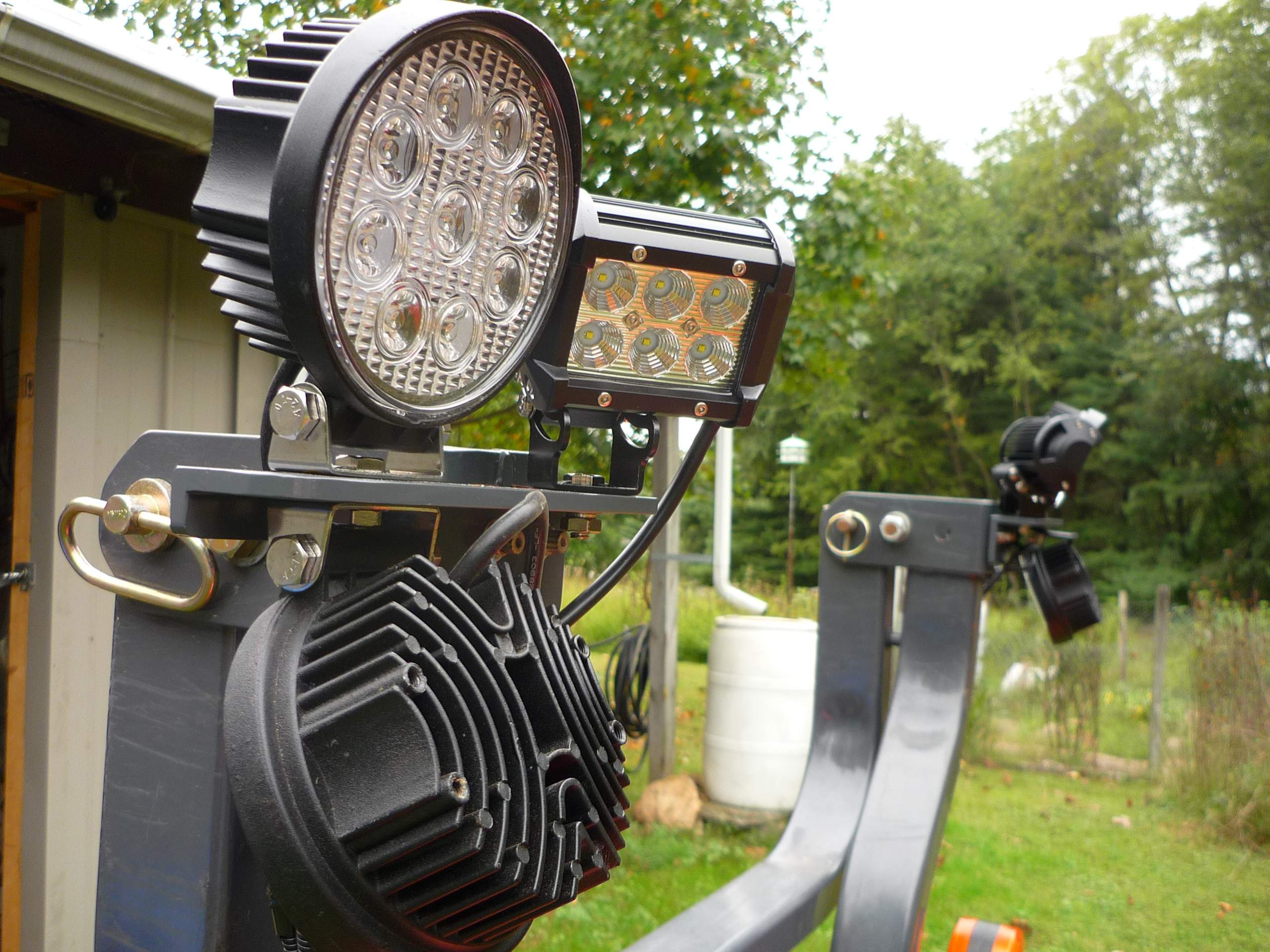

I have found this arrangement works well for me for plowing snow: I added the small side lights because I plow thru trees and brush lined areas, and wanted to see what's along side me, as well. All 3 switch separately, since I don't always need all 3 pairs. Maybe 75 bucks invested for lights, plastic loom, switches and relay, using my time and scrap aluminum for brackets. Some paint, of course.
/ LED tractor lighting...... #17
