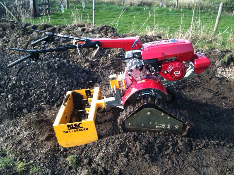

Jan 21, 2015 / Legit Box Blade #1 T TimberXX Platinum Member Joined Feb 4, 2005 Messages 813 Location Bergen County, NJ Tractor BCS 770 Italian 2 Wheel Tractor, Grillo 107d, BCS 853, Deere x350, Deere x730 If anyone is looking for a legit box blade for their two wheel tractor, I came across this. It's not on their website though, but interesting. It seems a lot better than a blade with ends on it. Sent from my iPad using TractorByNet Attachments image-1088710541.jpg 565.6 KB · Views: 1,490

Jan 21, 2015 / Legit Box Blade #2 O oldmech Gold Member Joined Dec 26, 2006 Messages 468 Location Quebec Tractor Two Gravely Two L One with 10 h.p Dek-Diesel engine one Grillo 107d and one BCS 735 diesel Hi! Very good ! I like the tractor As asian walk behind with steering clutch and track. We need steering clutch with track. Heavy 400-500 lbs a lot a better puller than our BCS or Grillo The box blade is heavy and tough built. and need a heavy tractor I think Thanks for share Good luck! Oldmech

Jan 21, 2015 / Legit Box Blade Thread Starter #3 OP T TimberXX Platinum Member Joined Feb 4, 2005 Messages 813 Location Bergen County, NJ Tractor BCS 770 Italian 2 Wheel Tractor, Grillo 107d, BCS 853, Deere x350, Deere x730 How does the steering clutch work different than the Grillo or BCS units?
Jan 22, 2015 / Legit Box Blade #4 O oldmech Gold Member Joined Dec 26, 2006 Messages 468 Location Quebec Tractor Two Gravely Two L One with 10 h.p Dek-Diesel engine one Grillo 107d and one BCS 735 diesel Hi! BCS and Grillo have a differential. If we brake one wheel for turn . Gears in differential add power and speed at the other wheel this one turn 2X more speed No differential With steering clutch. So if you press one lever the wheel come free no power and the other wheel turn at same speed as before For turn we must free one wheel. If we press the two lever we stop the tractor but PTO run So you have a live PTO AGRIA make a walk behind with steering clutch. Kubota and Yanmar make Asian tractors with steering clutch. China makes a lot now. Good luck. Oldmech

Jan 22, 2015 / Legit Box Blade #5 roadhunter Elite Member Joined Mar 23, 2014 Messages 2,619 Location Wyoming Tractor JCB 212SU Interesting piece of equipment.
