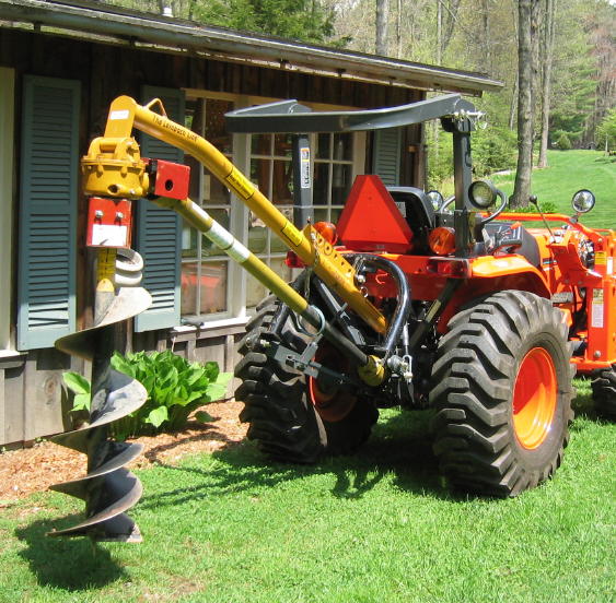

/forums/images/graemlins/confused.gifI just purchased one at an auction. What type of oil does the gearcase use? How do you adjust it for your tractor. It has alot of adjuting holes on the top. I have a Kioti CK20.

jgold:.......I have a Leinbach PHD on my B2710 (about the size of your
Kioti) and I used the first or nearest adjustment hole towards the tractor.
At this adjustment the bottom of the auger is about 6-8" above ground
level when in transport. .....RayBee

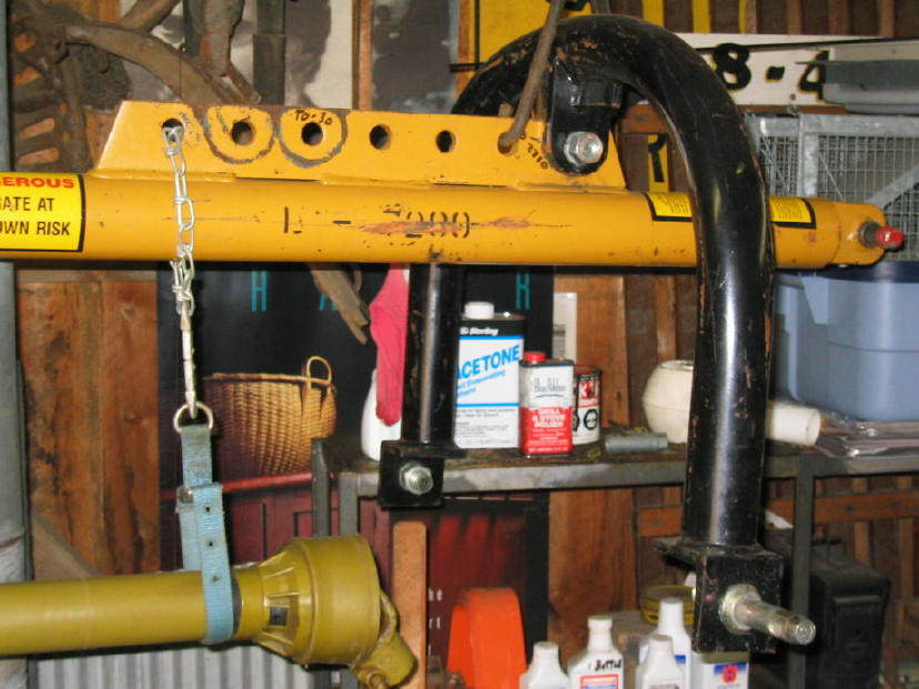

Greg; .... I went to my storage barn to re-aquaint myself with my PHD
& found that mine was an L-7200 not a 7200-JR. /forums/images/graemlins/confused.gif I don't know
if that is significant or not.
My previous Post showed the PHD the only time it was used by my B2710.
I previously used it on a TO-30 Ferguson. The B2710 did a great job.
Since the BH is nearly always mounted on the rear of my tractor, I can't speak too confidently about what you might be doing differently with regards to the 3 PTH , except to check that your lift quadrant adjustment allows a full lift and not stopping short of the top. I also previously said that the auger was 6-8" above the ground when lifted, ...but it's more like 4-5".
Another difference that could come into play , is a taller auger than mine,(mine is 46" tall ).
I don't recall which of the two B2710 top link holes I used, but I think the bottom one is the logical choice.
Look at the following pix to see if you can spot any difference in the model I have vs. yours. /forums/images/graemlins/smile.gif ....RayBee

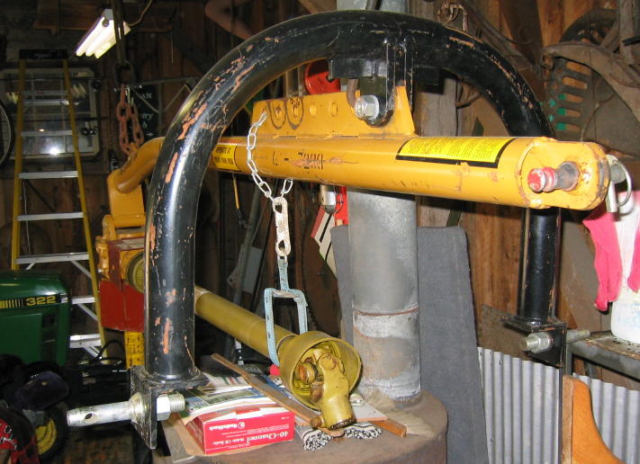

   / Leinbach Post Hole Digger #10
Greg: ....Here's another view. .....RayBee /forums/images/graemlins/smile.gif
Sorry for the poor quality of the pix ....The PHD is suspended from the
ceiling and surrounded by ...STUFF /forums/images/graemlins/blush.gif & hard to photo /forums/images/graemlins/grin.gif
