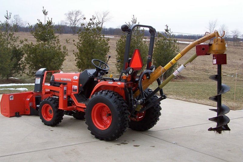

I have one of these that I used on my B7610. See photo. On that tractor, the auger is about 12" off the ground in the fully raised position. I also had a BX2200 at one time. My guess is that there would be precious little clearance. However, the auger mounts in such a way that it would not be too difficult to cut a few inches off the top to gain some clearance if necessary. This would, of course, lessen the max depth of the hole.

I believe the 3PH on the BX24 will be fine and I have confidence the BX24 can lift the weight of the 7200. I DO have a concern if the tractor could lift the PHD high enough to clear the ground. It appears the 7200 has some adjustment in the support bars that might adjust the angle thus lifting the bit higher for additional ground clearance. All the dealers I emailed said they would recommend the 7200jr. I think they are hesitant to say it will fit just incase it does not.

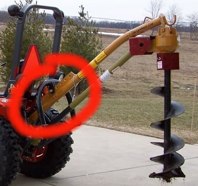

This is true. Notice the several holes circled in red on the attached photo. But this can only do so much.
BTW: I checked the model and this is actualy a 7400. I don't know if or how it would differ from a 7200.
