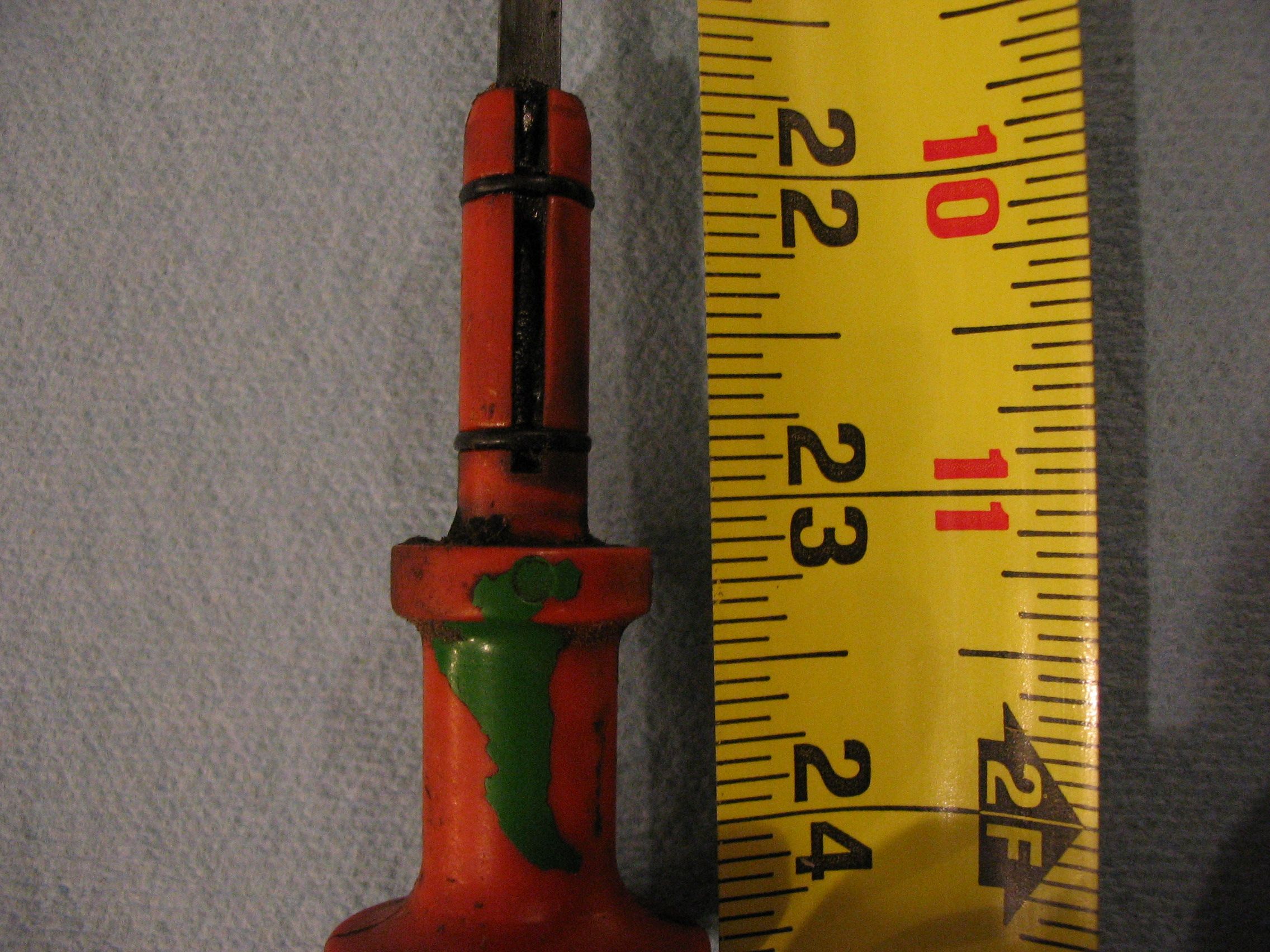

Sorry about the delay. We have been really busy.
The total length, from tip to the handle flange, that stops against the tube is 23 1/8 inches.
Here is a photo of the handle section

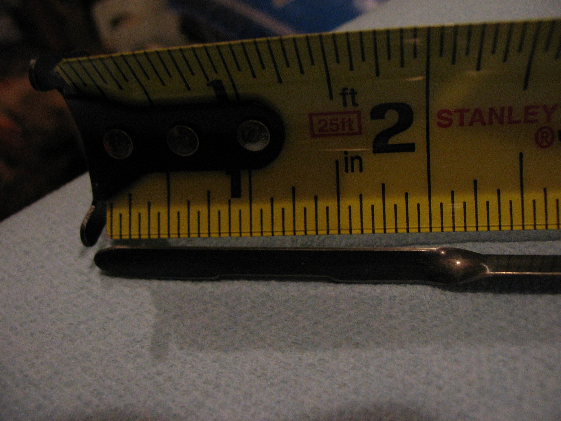

and here is the tip section
Mine is a colar shift tranny, not the synchro and it's 2WD. Not sure that makes a difference but just in case.
   / lenth of dipstick on 2555 rear end
Slavetohorses,
Something isn't right about this.
I know I am not going crazy, but there is no way my JD 2555 had a dipstip that long. I seem to think it is about a foot long, with about the same amount of oil markings.
Does your dipstick go straight down next to the PTO output shaft, or does it go forward and then down, kind of like over the rear axle type of situation?
By the way, I really do appreciate you taking the time to try to help me, especially going thru the trouble to take and post those pictures.
David from jax
   / lenth of dipstick on 2555 rear end #7
Mine does as you described, run forward to the right of the diff. It is not the same as yours.
My neighbor has a 2755 that might have the same rear end as yours. I will check this weekend.
   / lenth of dipstick on 2555 rear end #8
Hi Sandman, The 2755 has the same rear end as yours. I pulled the dip stick and it measures 8-1/2" same measurement points as before.
