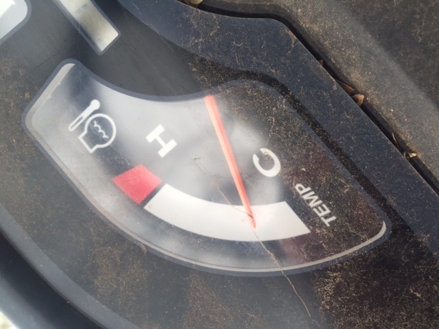

great little accessory! it doesn't get cold enough here for me to *need* a block heater but i like the peace of mind that comes with knowing that i'm saving a bit of engine wear - plus the machine gets to operating temperature a bit quicker when i need to plow before leaving for work.
here's my temp gauge on startup (~20F outdoors)
