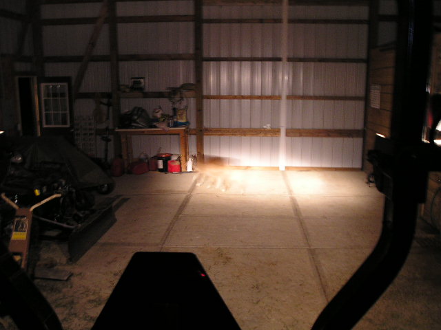

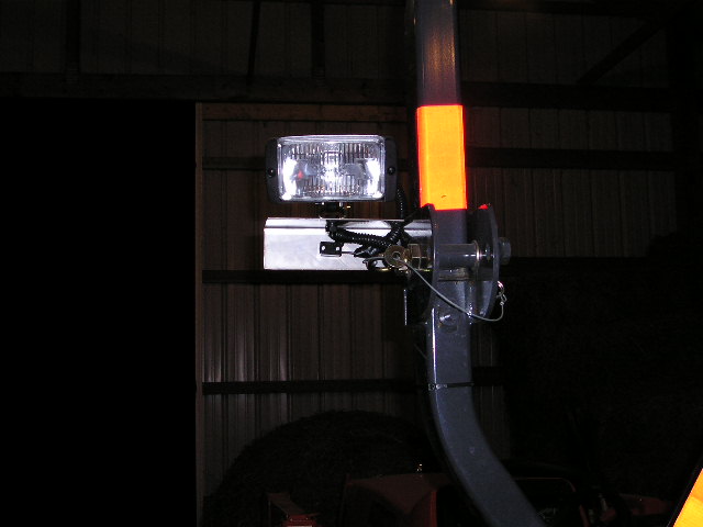

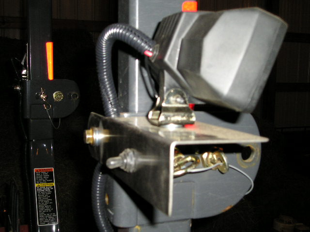

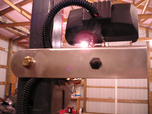

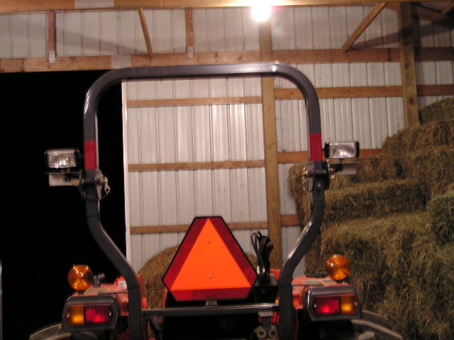

Well I added some lights to my L4400. There is a nut that is welded to the ROPS and I thought that I could use it. It looks like it would be for a canopy. I had my sheetmetal shop bend up some 12 gauge 316 SS. Then I drilled some holes and wired it up. The wires were there from the factory under the fenders so I just ran some corregated tube and wire up to the lights. The switches are prewired and I put some rubber protective covers over the switches for moisture protection. I can also swap them so they are inside the ROPS if I need to (so they don't get hit bushhogging. But this way they can also rotate 360 so I can also use them for the front. Hope to use them once we get some snow.

Great Idea. If you can get them to do it again, I would bend the metal so that it protects the light. Not that you might break it, but I hit branches all the time, and then spend time adjusting lights when I could be driving in the dark...

Wood Yea that is why I had the brackets made so they could be swapped left for right and then they would be inside the ROPs instead of outside. But may still get hit. Thought about a wire cage around them with some 1/4" tube

Chilly, I attached to the rops because the bolt was already there. Just a 3/4" M10x1.50 and some lock washers, don't know if the 3400 has the bolt or not. I used the 55w flood beam still shines all around pretty well. That is what I figured as well (110 watts/ 12V = 9.1 amps). Doesn't even dim the front lights.
