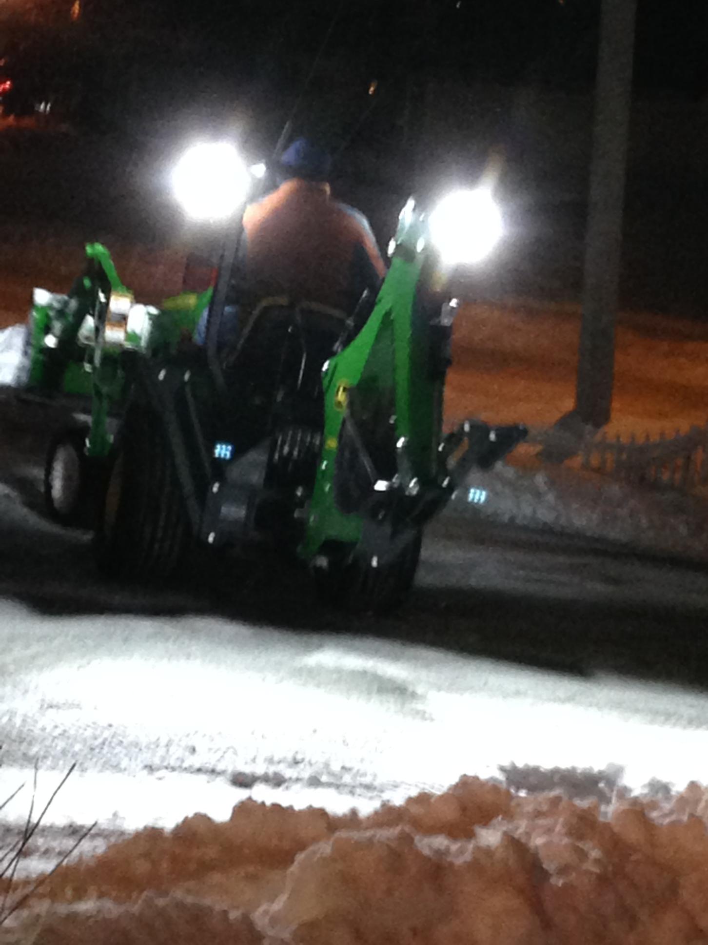

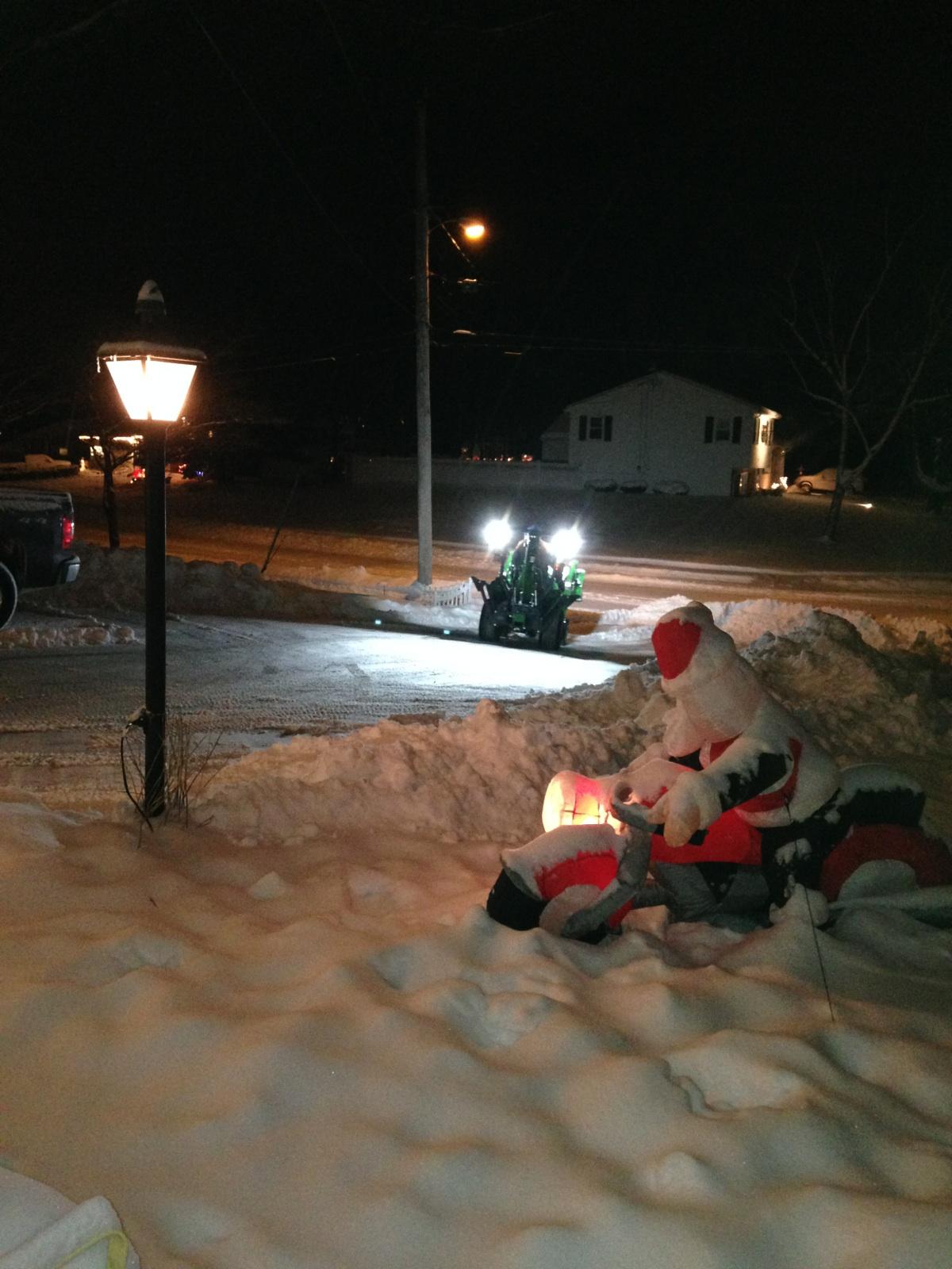

I got these lights from ebay to mount on my JD 1023. I mounted them on the side of the Rops because I have to fold it to get in garage. All I can say is dam they are bright!!

Do you have make and Model on the lights. They look sweet. Did you have running lights already that you had to remove? I have a 1025r and where you mounted these I have hazard/directional lights.
/ Let there be light
Let me first say, Thanks to both of you. Ok I don't have a model of the lights but if you search ebay for this # 130980021215 That will take you to them. I paid 130 for 4 of them delivered. I mounted them above the hazard lights. I didn't have the running lights so when I wired these lights, I used the switched power that was for those running lights in the dash. Take the left engine cover off and you will see it right there. These pics should give you an idea where I mounted them.

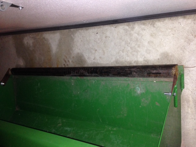

I've used leds before and have no complaints. I also put a pipe over the cutting edge to save the driveway from getting too scuffed up. It also doesnt dig up the lawn as bad.
