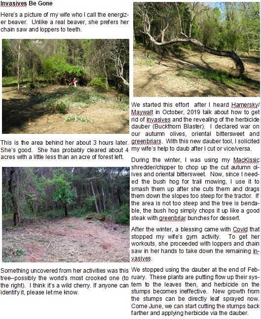

The neighbor to the left had been renting out his property to various people the last 17-18 years. He finally came back a couple years ago. Since his woods behind the house were very overgrown, he hired an outfit to bring in one of those forest mulchers. Actually, it was a Cat with very heavy duty flail mower on the front. Took them a couple days doing about 2 acres.
In the meantime, it's taken my wife and I since October, 2019 to do about 5 acres of downed trees and invasives here.
Ralph

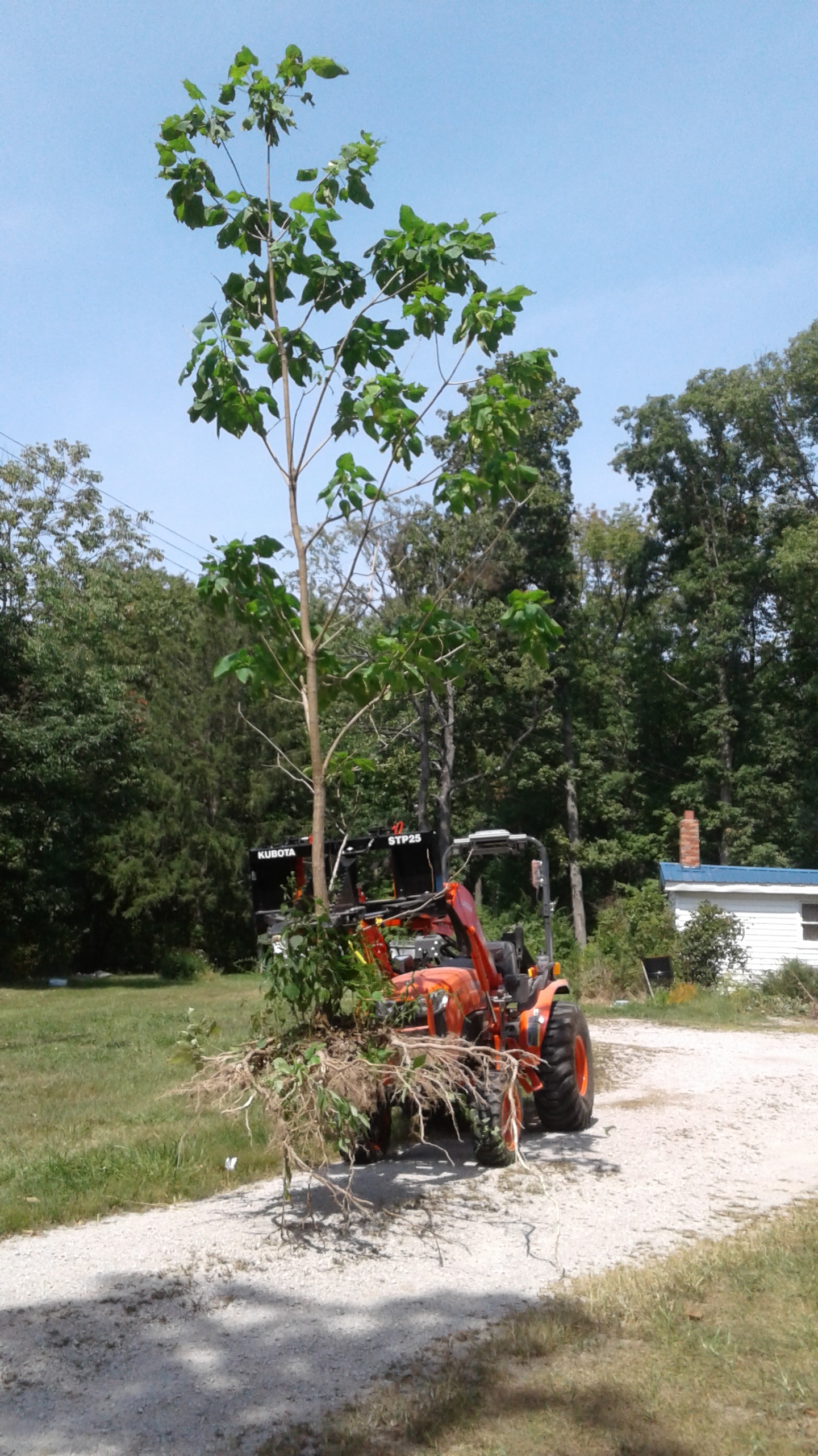

Operating Techniques: Skid-Steer Forestry Mulcher - Tech Tips - Diamond Mowers - YouTube
Disc Mulcher or Drum Mulcher -Which is better for forestry work and land clearing - YouTube
Marshall Tree Saw - YouTube
Danuser Intimidator: Take Control of Your Land! - YouTube
Forestry mulchers usually require high flow hydraulics.
Like the Marshal tree saw , no spinning blade, flush cut - you'll need to haul off trees
Small trees, look into the Intimadator tree puller, thought it was to big for my B2650 went smaller
