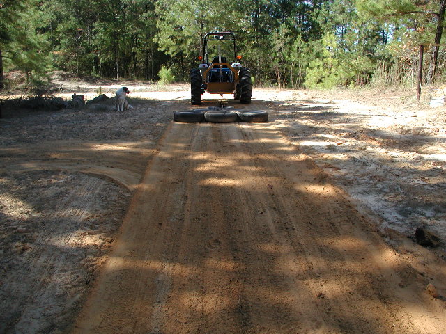

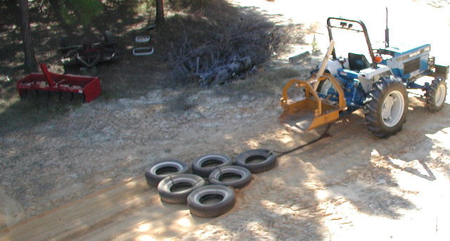

Here is what I have been using for years to do the final smoothing. The good part is most of it is free.

A picture of the leveler in action!

The setup is really a finish leveler. It can only move loose dirt but it will get the surface very smooth. Let me know a little more about what you would like to do with it and do you have a FEL to rough level with?
