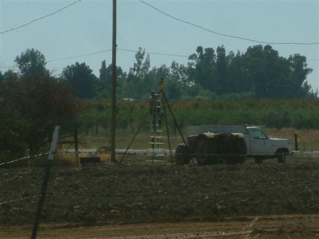

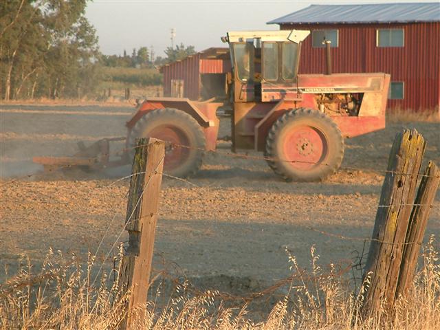

My neighbor flood irrigates three 10-acre alfalfa fields. To get these properly leveled and sloped, he uses a D-7 Cat and a 10-ft wide laser-controlled scraper. It's a big job.
First, he used an IH 4366 tractor and a multi-shank ripper to break up the hardpan down to 18-24 inches depth.

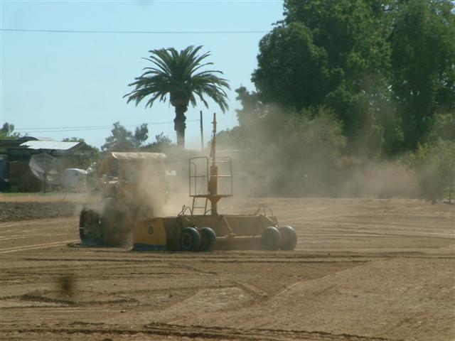

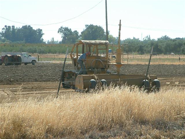

Then he leveled and sloped with the CAT/scraper.

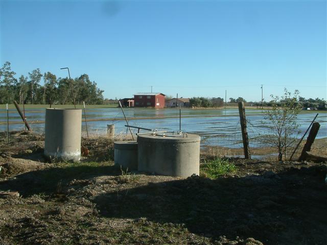

Testing the flow over one of the 10-acre fields. The checks are about 105 ft wide.
