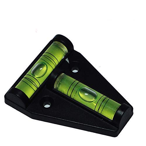

I am in the process of removing a good sized bank of material from one side of the house and filling other areas. Short of taking the time to survey and mark grade stakes, is there anything that I can use on the backhoe or tractor to give a quick visual reference? Almost toying with the idea of finding a fairly inexpensive (but bright enough) laser level and putting it on a gravity gimbal near the operator's station on the BH. Or am I reinventing the wheel?

RV level on a flat spot near your seat.
Bruce
   / Leveling guides #8
Bruce
I’ve seen folks use torpedo levels on bigger excavators and back hoes. If the machine (typically at the controls) is level, you can use a curled bucket to sweep a pad and verify level.
