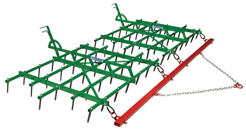

The roto tiller and then harrow.

   / Leveling semi-packed dirt after removing brush? #9
I don't think he meant power harrow.
