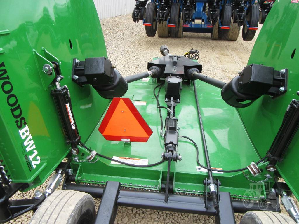

Anyway, I'm pretty sure I know how to do this, but wanted to check and see if there were some tips/tricks. I'm getting some gouging on the wings (skid shoes) when I mow. The center section wings never hit, which makes me think that the wings are a little bit lower than the center (and visually, it appears that they are). I see how to adjust it on my mower, there's a turnbuckle (that was so tight that I had to get a 36" wrench to break it free!) that I can use to lift/lower the wings. But, I'm not sure what I should be measuring to see if it's "right"? Skid shoes on the center section to the ground and then skid shoes on the wing to the ground? Seem to make sense, but the Woods manual is worthless on this area, it barely tells you how to do it, let alone where to measure to make sure it's done right. Adjusting the turnbuckles seems to pick the wheels up on the wings, which is exactly what I want, the wheels are a little lower on the wings (visually) and that's causing the wings to gouge in places where the center section is fine. I'm guessing this adjustment is for all cutting heights, once everything is level it's level regardless of where the cylinder is positioned? Seems like it would be based on the way it works mechanically, but wanted to ask. I'm going to drop it down to cutting height on a level section of concrete and start measuring, just not sure what to measure and what those measurements should be (should the skid shoe on the wing be the same as the skid show on the center section, higher, lower, and, if so, how much, etc)?
Thanks for any help, I imagine this is the same for all batwings (although the adjustment procedure is different), so if anyone has leveled a flex wing cutter, pass along the experience and how you did it.

So, simple version, the machine should be dead level across the wings and center section if it's on level ground? Yes, I have the turnbuckles and if I look at it now, on level ground, it appears the wings are a bit lower than the center section. That's what I'm looking to adjust (the height of the wheels on the wind sections).

So, yours looks something like this one?
If so, adjusting the shiny turnbuckles will adjust how far up or down the wheels on the wings sit in relation to the main wings.
Despite what Leonz says, it shouldn't pucker or bend the wings to adjust that as long as you leave the wing fold hydraulic remotes in "float" as that is how the system is intended to have the wings leveled.
As for where to level, I would run the wheel lift cylinder all the way up, block it up so it cannot fall and crush you, then go to where the blades mount to the stump jumpers and measure height there at the front and back. They should be within 1/2" of the same height between the main and wing decks and the front should be a little shorter than the rear.

Might I suggest you look at the picture I posted of the model that the original poster has? The only turnbuckles on it are the ones that adjust the height of the wheels on the wing in relation to the wheels on the main deck. They don't have anything to do with the amount of flex that can occur below horizontal. They just set the angle of the axle that the wing wheels mount to in relation to the angle of the axle of the wheels for the center deck. That adjusts the height of the outside edge of the wing in relation to the height of the center deck.

Yup, mine looks exactly like that, even the same color! Which clashes badly with Kioti Orange, but, hey, what are you going to do, right?
That makes sense, but.. Ugh. The thought of crawling under there over and over to get the "right" measurement seems like a bad day to me. There's really no "measure point" on the mower? I get what you're saying, measure off the blades, but why not a little sticker/weld/etc on all 3 sections that you can see from the outside?? Measure here on all three decks and make that measurement the same, easy, right? Because I'm not setting mowing height here, I'm just setting level, all I need is a level line across the decks to work from.

I would measure to that once, then make a mark to show the cut line somewhere on the outside for future reference, that way you don't have to crawl under it again.

Well, that worked. Honestly I did it mostly by eye, the wings looked low, they look level now. Close enough, right? ;) The cut looks much better and less gouging.
I also lowered the back a little bit, it was riding low in the front (which is where the skids are). Man, what a job that was, there's no good way to get a wrench on that adjustment and it needs a LOT of force to move it. Lots of fun, but I got it riding more level front to back too. Good news, all of these should be one time adjustments, no need to move it again once it's set for my tractor. What a great cut this thing lays down! I was testing my adjustments and almost mowed the property again well, just because it's fun to watch it work! ;)
