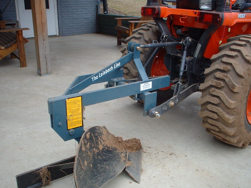

I just puchased a new Linebach 1-12 plow. I purchased this plow after the recommendation from my local implement Co with my type of terrian. After looking it over good I realized it was built a little heavier that I thought for a 1-12 plow and after using it plowing a couple of gardens it worked great.
Cost was $289.00
Here is a pic.

A couple of questions for you, having no plow experience, yet, and about to embark upon purchasing a plow for similar uses:
1. Could you get 12" deep on the first pass? What kind of soil do you have, that made this unit the best choice?
2. What HP tractor is the plow attached to---I'm assuming from the "HST" on the fender, it's in the 40-range?

I can see the plow is flat to the 'ground' in this picture, but to be adjusted correctly for plowing, seems to me it should be flat to the ground only when the left rear wheel is off the ground the same distance as the depth of the intended furrow (plow 6" deep, then 6" off the ground).
If plowing as it is adjusted, the bottom of the furrow will not be level (flat) right to left, and you will just be dragging the point of the plow under the dirt. The front to back leveling is done with the top arm adjustment. The right to left leveling is done with the height adjuster on the right 3pt lift arm (at least for this plow).

Don't mean to answer for Jim, but according to his sig line, it's a B7500 HST which is 21 gross HP and 16 pto HP.
