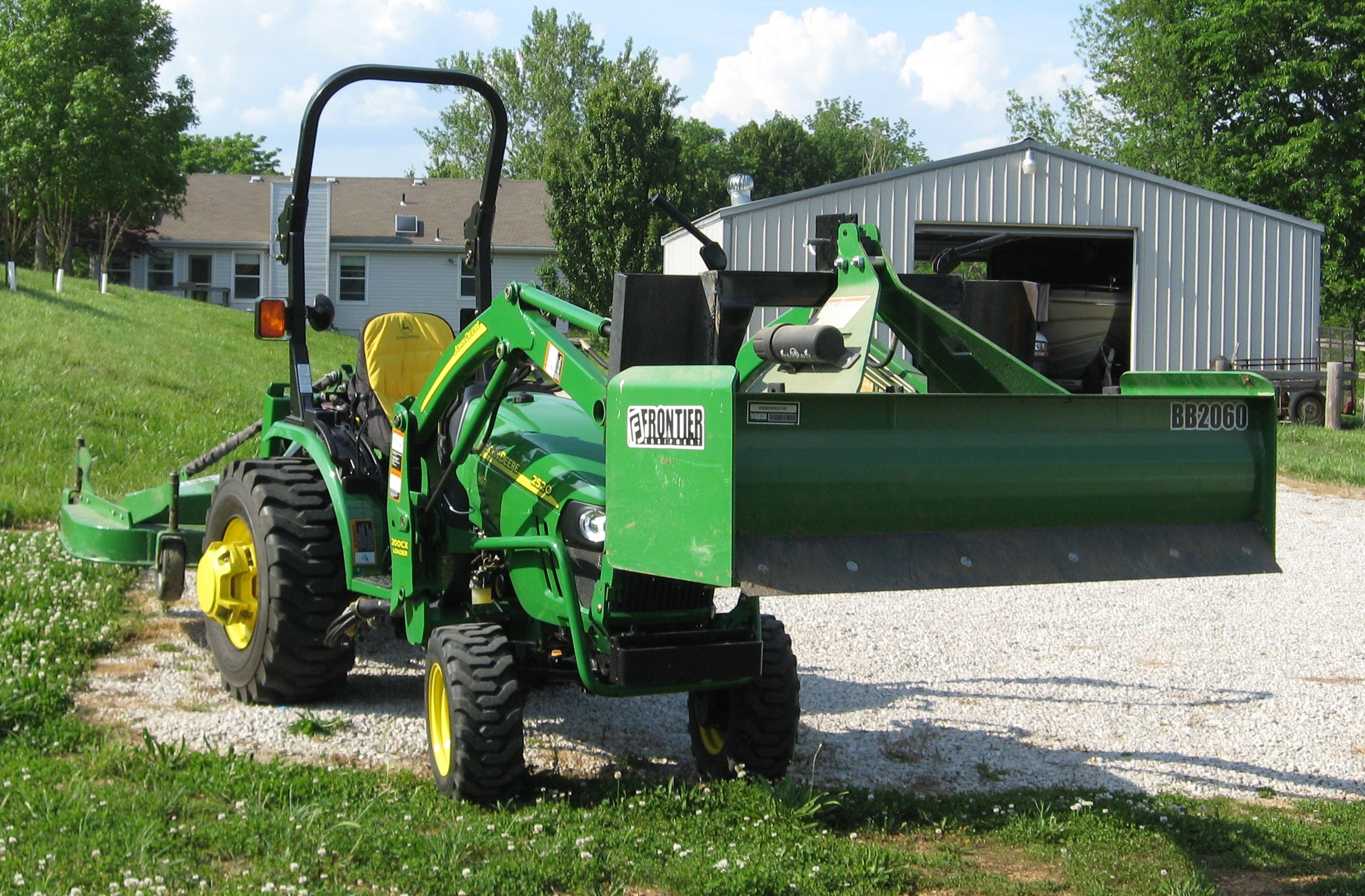

I use a front quick hitch adapter and move them with the loader.

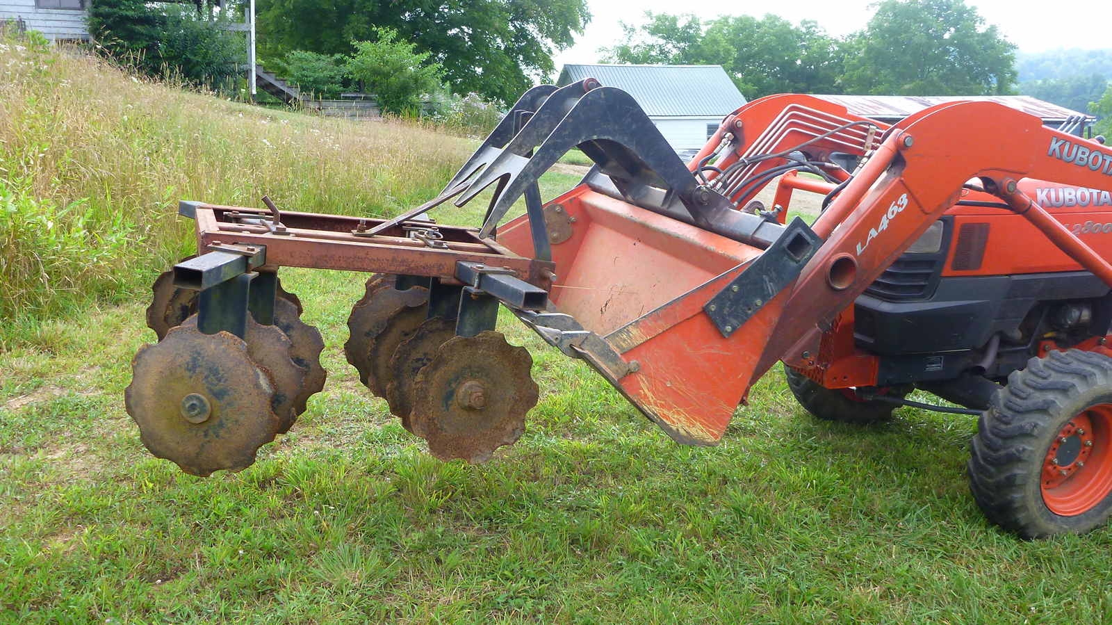

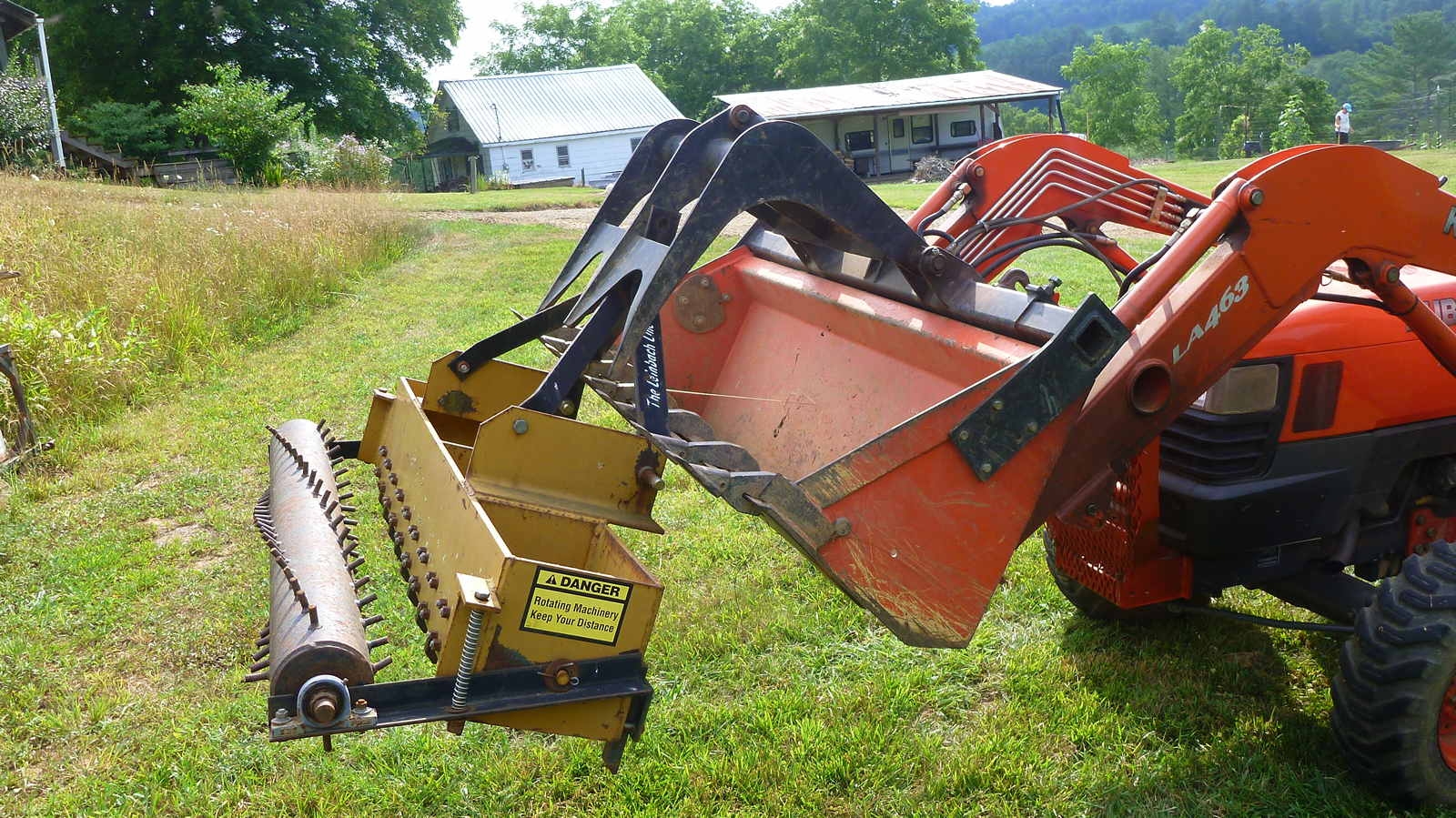

I use my bolt on grapple to pick them up.
Same. Built 2 of those. First was the mount for a snow plow. 2nd was to replace the first when I sold that plow & tractor. I use it occasionally, but not that often these days. A deck over trailer makes loading things so much nicer without sides or fenders.
