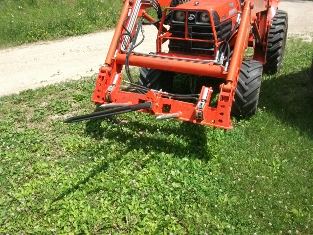

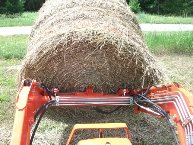

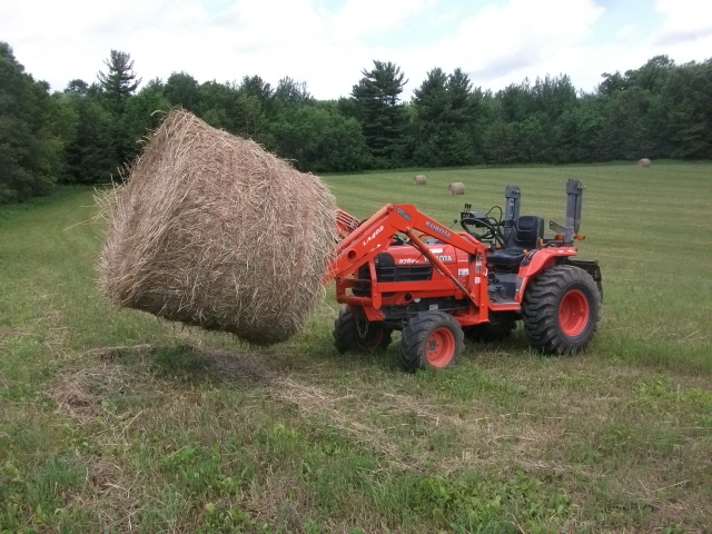

I just moved some bales with by B7800, Don't know why you could or should not with your tractor. Bales vary in size and weight, these were 5'-5.5' in diameter and less than 900 lbs.
I think the 700lbs is very conservative assuming the operator wont ballast , etc. that b7800 is half the weight of the 4510 so I imagine it would handle one of these big bales ok. Won't hurt to try. I only have 20 bales at most per season and I just sell it and would be nice to load it without calling the neighbors.
