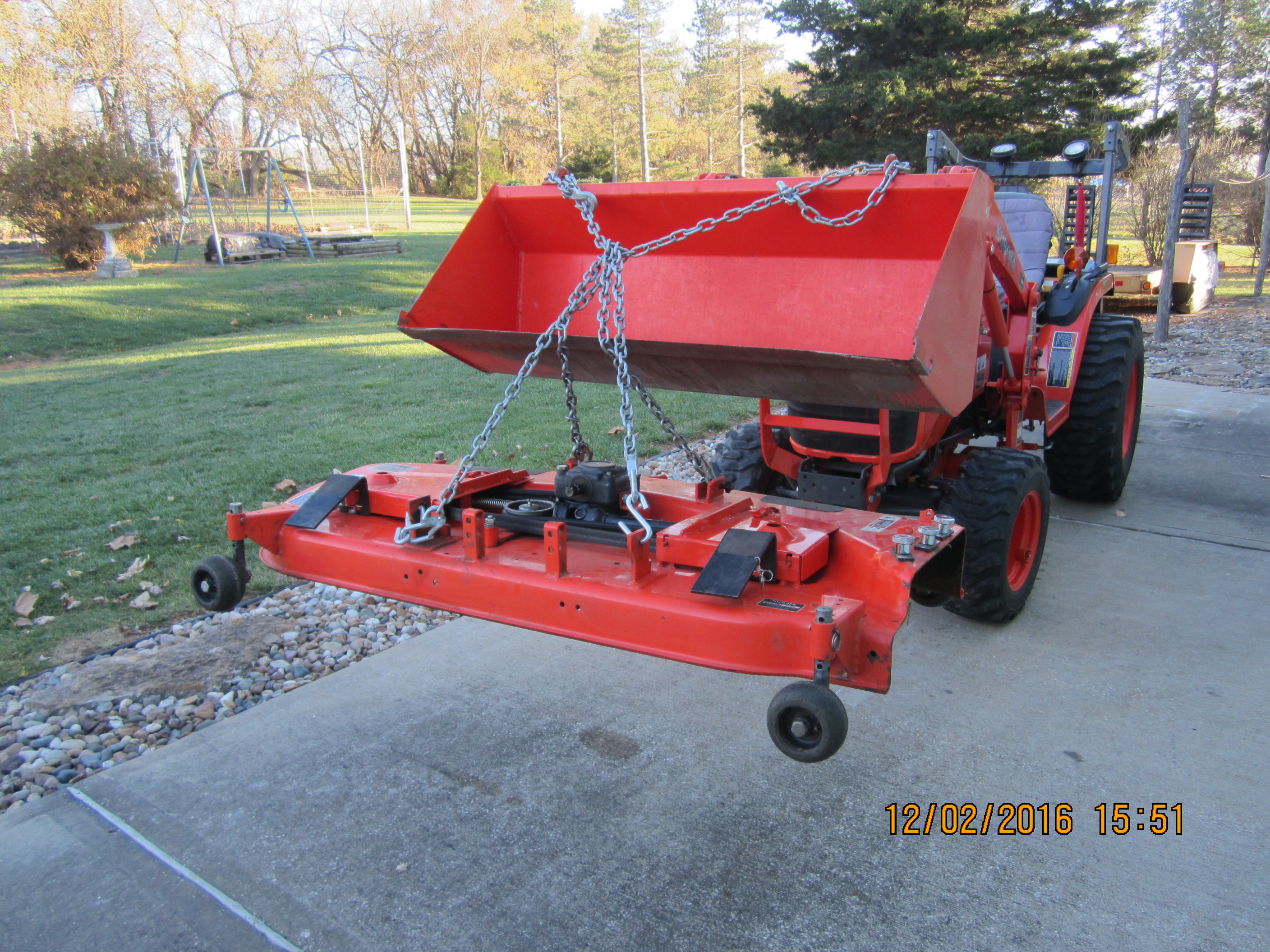

well I have to admit I never did anything, yet, since by the time I removed the spindles and all the equipment, the old
deck wasn't terribly heavy and I was able to lift it up on top of a cut down sheet of plywood, on top of a pretty heavy duty plastic service
cart. Not overly stable, but it worked. And reminded me I really needed a good solution here.
Likely to be pallet based.
Most of the time I'm just changing blades, and I have a good lift ring in the front of my Gravely to grab. The JD X750 has a strong
front bumper/reinforcement that is easy to hook a chain to. No matter how many jackstands I put on, it still makes me nervous crawling under there.
Isn't likely the loader is going to fail, but I could do something stupid with the chain, perhaps..., and it could slip off.
So the idea of lifting everything up to level working height like a mechanic in a garage is very appealing.
Basically trying to recreate a car lift with a HD Construction Attachments set of forks and a reinforced pallet.
Since I could not depend up on the loader hydraulics to maintain height, they all leak down, I'd have to make four boxed supports, for each corner.

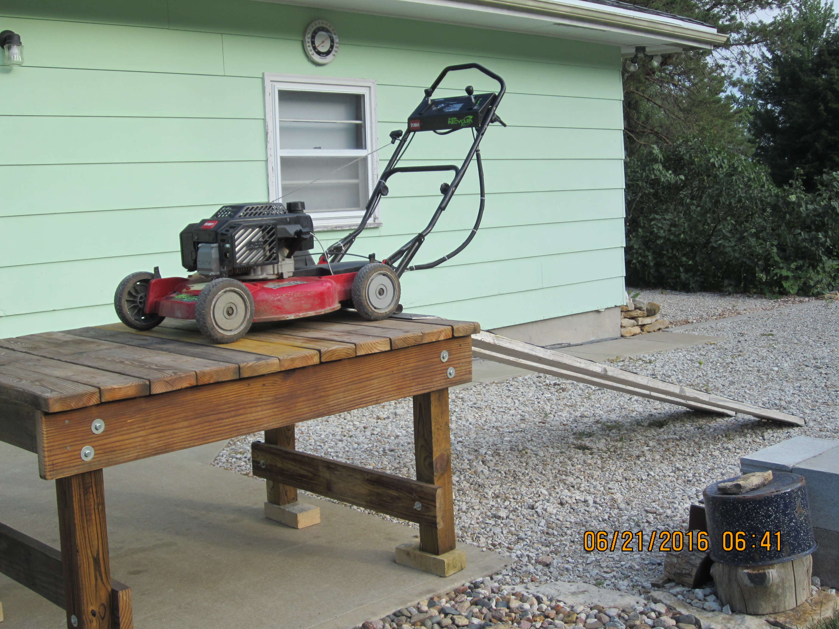

Well, I was lucky enough to have found a scissors lift with it's own hydraulic power pack about 20 years ago for a very good price. I made a 4'x 8' steel frame for the top to make it larger. I usually use it to store junk on. It would very easily lift a ton. When I can I use it as welding bench as you can vary the height to anything up to 40''. I also have a pallet jack that will lift to 6'. As for your situation possibly build a work bench whatever size you need and a pallet the same size. Park whatever you are going to work on on the pallet and then set everything on your bench if you have enough tractor. Set up your bench so you can move it in or out with your tractor.

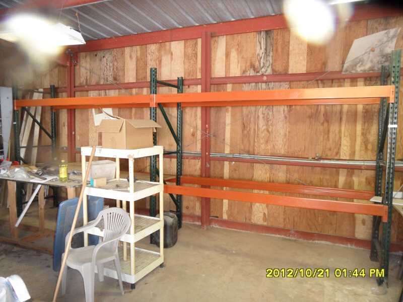

Do you have $$ for some posts, a few 6x6's and a bunch of 2x6's?
Do you have a place you could build a "work table"?
Alternatively find a section of used pallet rack. Used pallet rack normally goes for about $20/beam, $50/upright and $20/ mesh shelf. The minimum needed is 2 uprights and 4 beams. So for $220 you could get the minimum so you had a shelf to work on and vast potential for expansion.

pallet racks, good to know. There is even a usedpalletracks.com.........
will that hold a ton?

There are Costco racks that hold 2000lbs per shelf (dispersed), with 4 shelves for total of 8000lbs. They are $150, but go on sale for $125 at times. I have several and have loaded them with heavy stuff (not near the rating) and they appear to be holding up well. Perhaps one could be adapted to do what you need..

No matter how you lift something never, ever get under a slung load. Lower the load unto strong supports till it just rests on the support before getting under tractor or implement. That way you have the sling and supports in case one or the other lets go. You seem to be working on a hard level working surface but sometimes what seems level ground outside just isn't. Unless the supports have a wide footprint they could topple over on uneven or soft ground
Not to nag, but don't get under an implement that raised. All it takes is a busted hydraulic line or a leaking valve and the implement could either sag or suddenly drop with you or parts of you under it.
