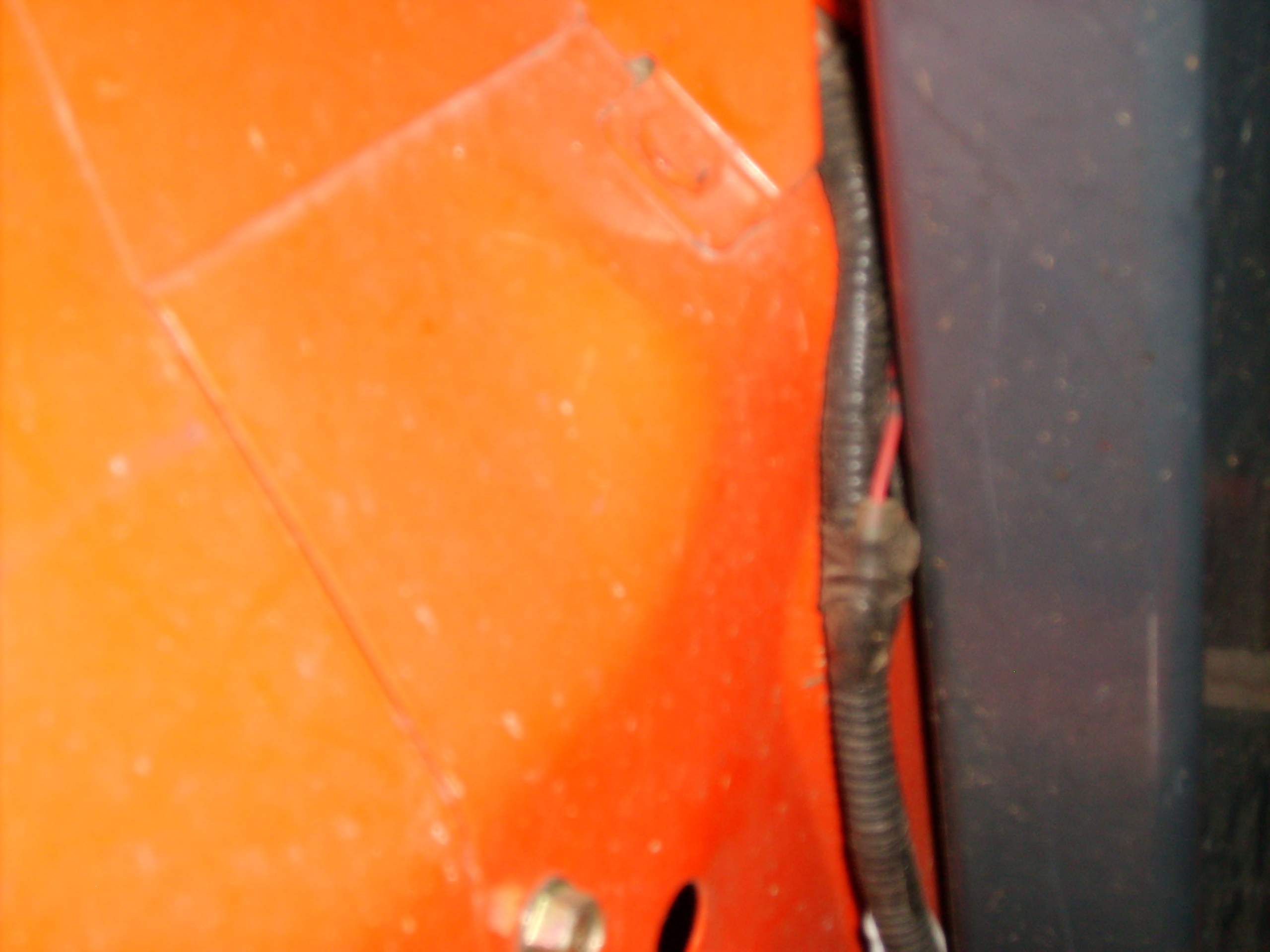

Though I can't comment on forward facing lights I did mount a rear light above my 3PH on my M4800. Just in case you don't know at the base of each upright of the ROPS there should be a factory installed power pigtail. It'll be stubbed out from an electrical flexible conduit. I tied mine into that along with an inline fuse and ran it to a weather proof switch and on to the light. Anyway, thought I might mention it. It might assist in your installation.

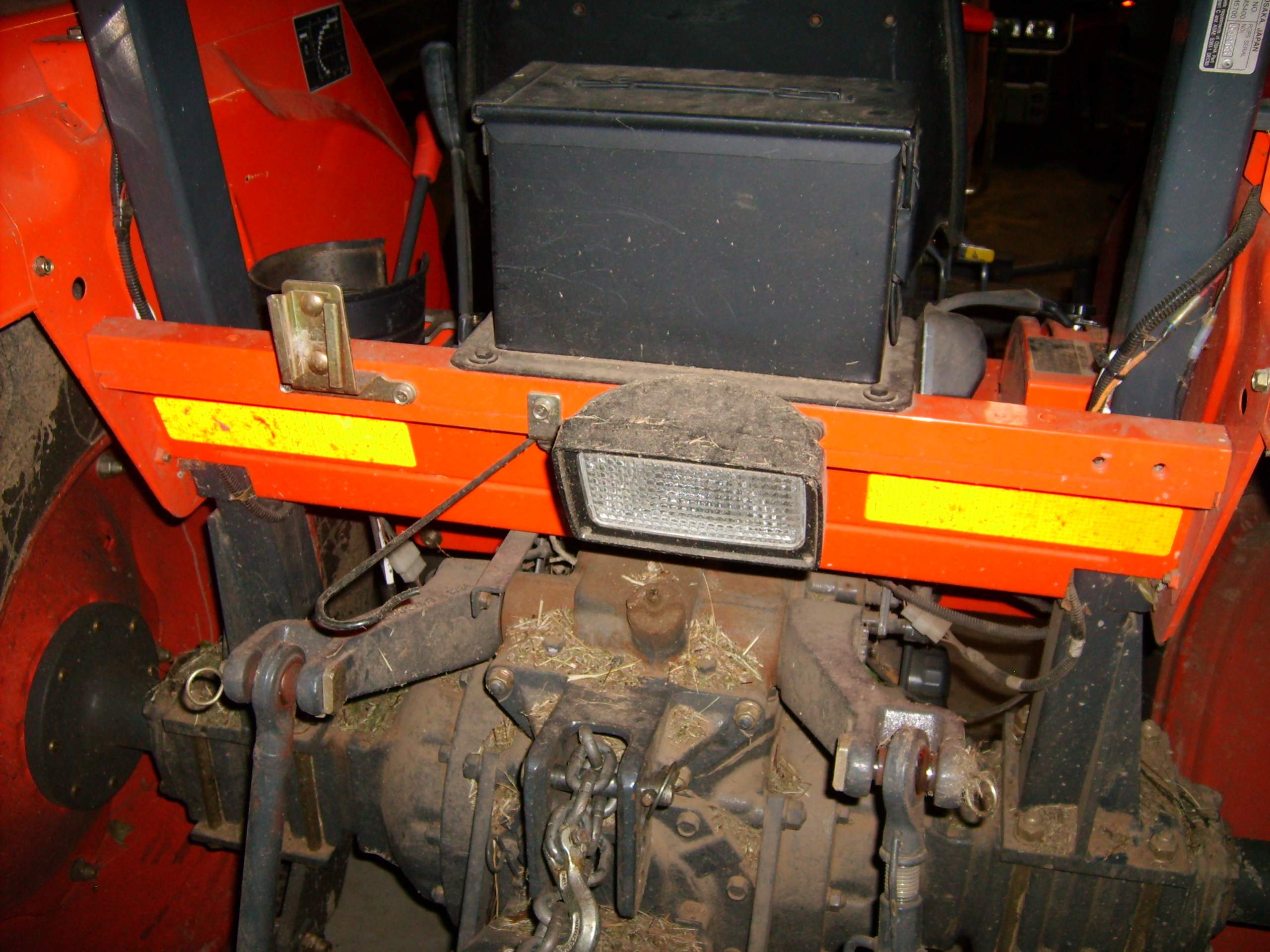

HCJ, I bought them at Atwoods which our local version of TSC. They are standard rectangle shaped and mounted them on the back lip of the body next to the bracket for the SMV placard. I'll have to get you a pic of it this evening.

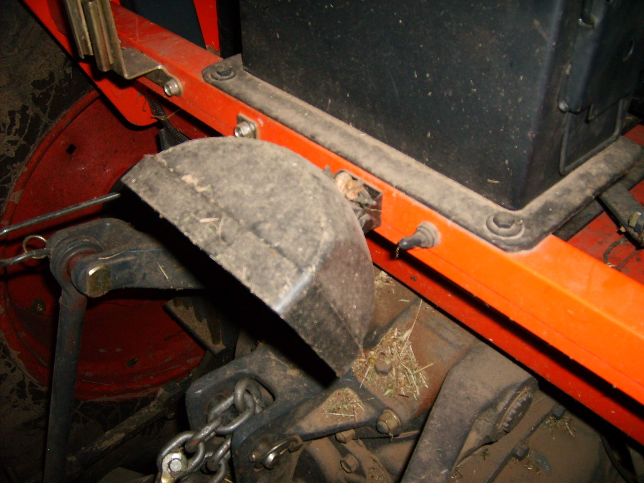

Thanks! Don't go to too much trouble. I read more on various posts and have decided to try some LED lights by Truck-Lite. I ordered three today, two forward facing trapezoidal floods and one rear flood with a shorter projection. They are a little pricey, but sound perfect. Lower power draw than halogens. I plan to mount them on the underside of the ROPS, and I will probably drill my ROPS to install them. I know that is forbidden, but I can't see how several tiny holes will compromise the integrity of the bar. I will probably switch them all together. Where did you place a switch?

I was able to get those pics. The first one shows the light and where I mounted it. The second shows the stubbed out pigtail on the wiring harness by the ROPS. The 3rd one shows the location of my switch. My original plan was to mount the switch and access the power at the steering column area but found the power source at the back so just made it simple. Anyway, I hope this helps. Tractor is pretty dirty I was doing some brush hogging last weekend.:D Tractor time!:D

Thanks for taking the time to post these pics. That looks good. I thought about one rearward facing light in the middle of my ROPS, but your lower install may be better in terms of light projection at your implement, and keeping the bugs away form your head.
By the way, I like your "tool box". I guess you also feel that the Kubota factory box is worthless. It is way too small.
