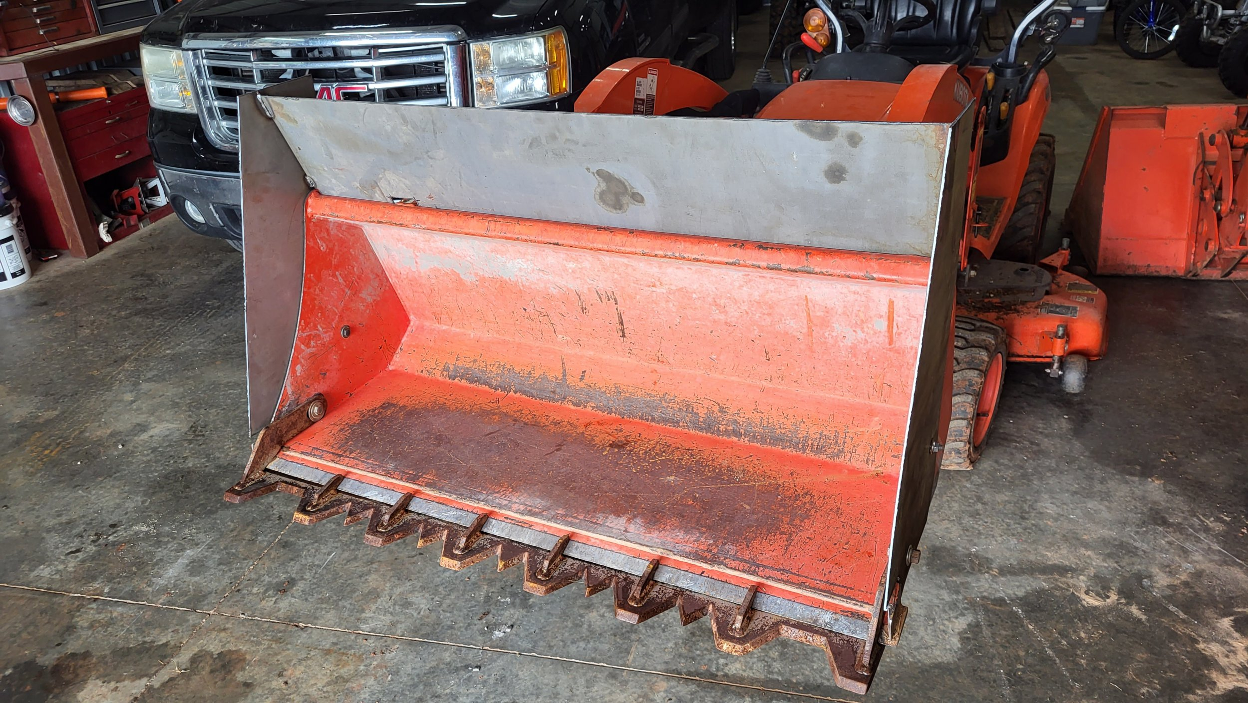

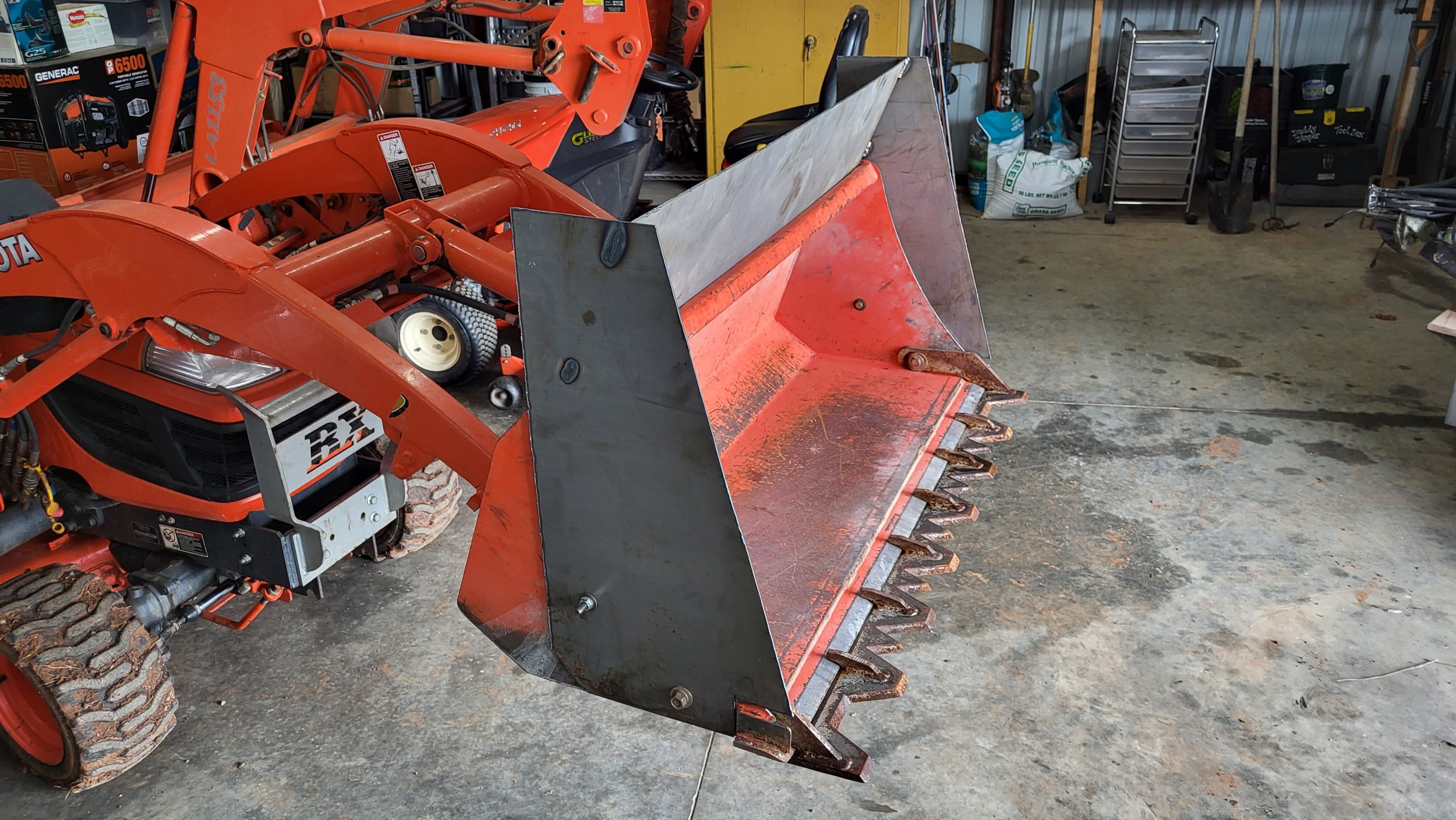

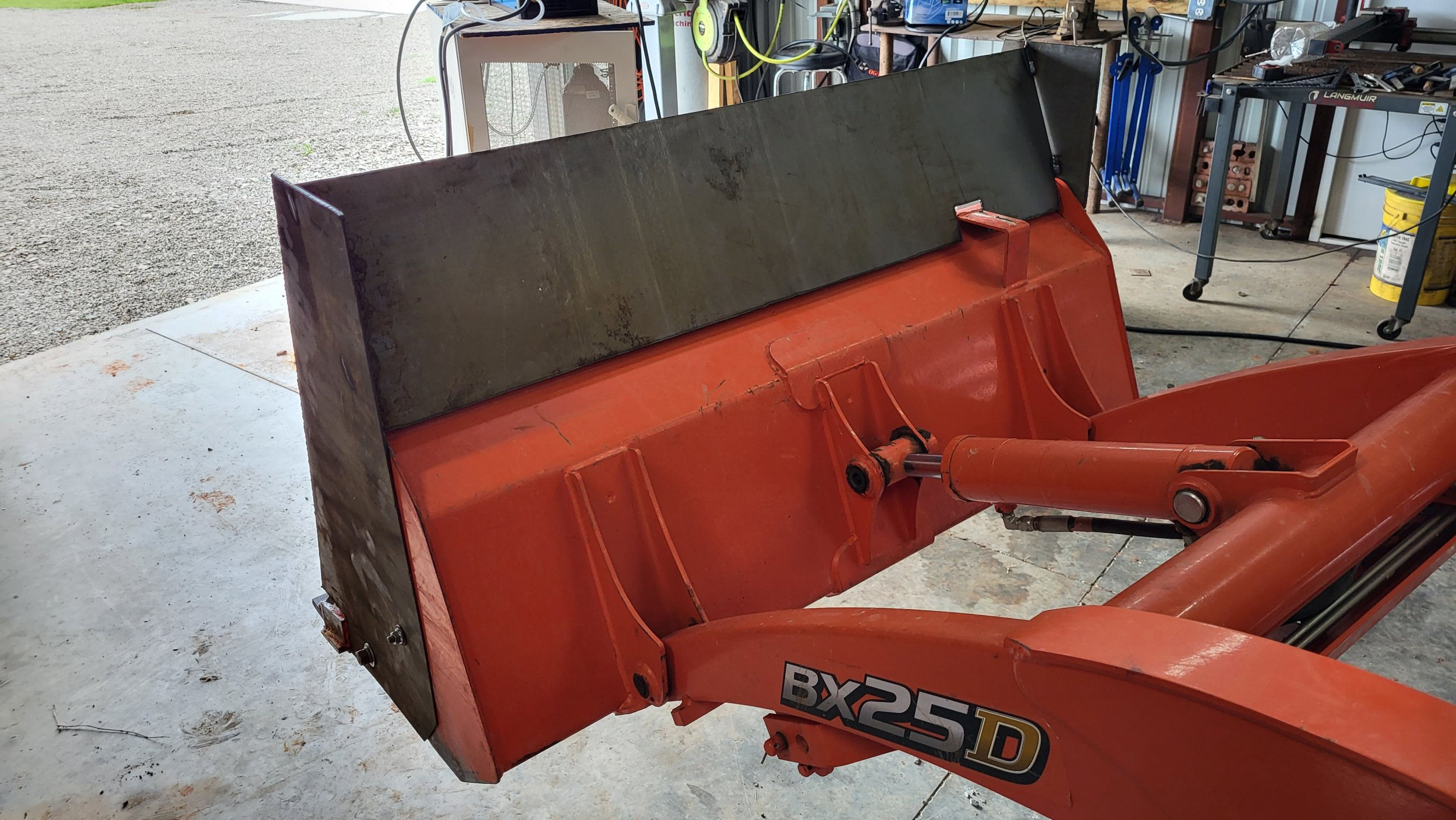

Built this over the course of the last hour or so, wasn't planned but I just had some mulch delivered and this will help move a little extra each scoop.
I used 14 guage material because that's what I had laying around. If I had expanded metal I would have used that for the upper part.

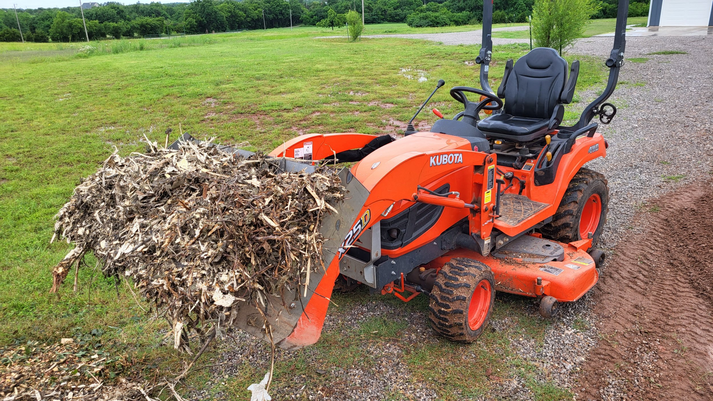

Just tested it, it worked. I need to add a support in the middle, it's a little wobbly, no surprise. I'll cut the parts of the sides off that's not needed and maybe, just maybe, paint it :)
