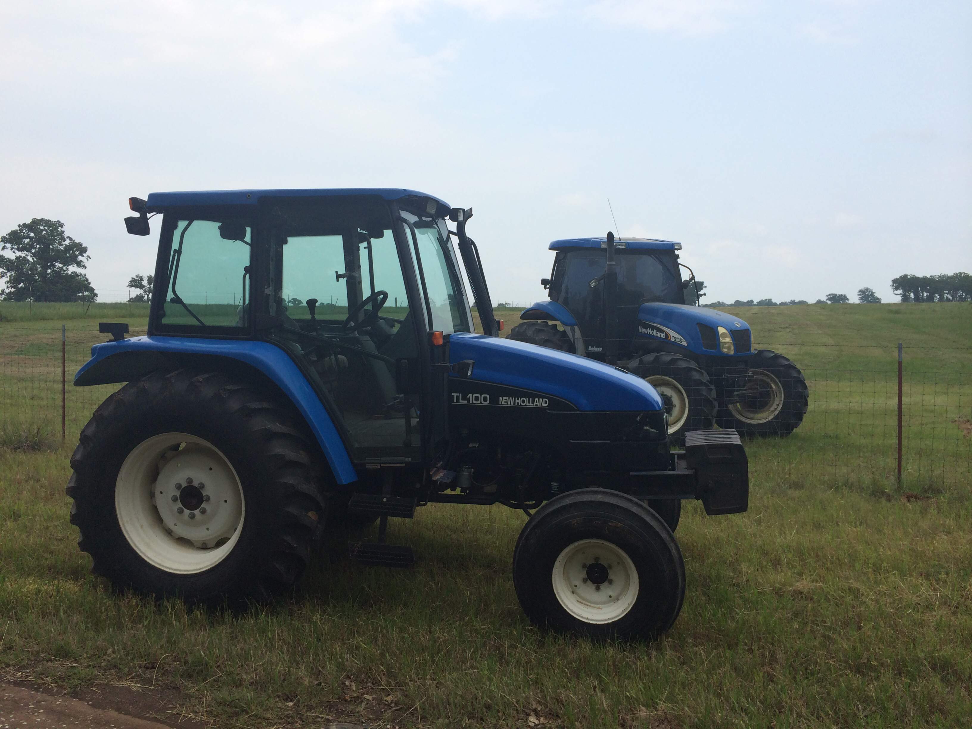

The Kubota 108s weighs 8576lbs,the 9960 is 6610,both 4wd cab models by tractordata.My neighbor has a BH 20ft and it is big and heavy,pulls it with NH TS135.Both make my NH TL100 and 15ft look small,setting side by side. image.jpg
What 20ft are you looking at? Weight is an issue when get into mowers that size and having a tractor that will own it,unless just on flat ground in my opinion is going to be more in the 8+ range. And to add he bogs the 135hp tractor often(I don't know his pto HP)whole different ball game then a 15ft in the heavier duties,all depends what your in the business of mowing.
