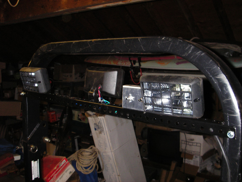

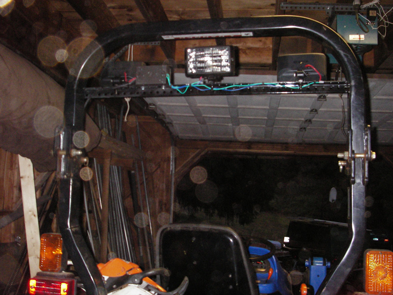

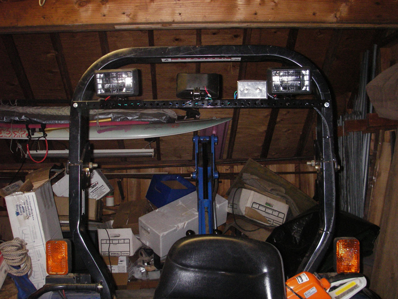

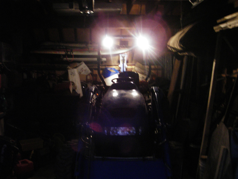

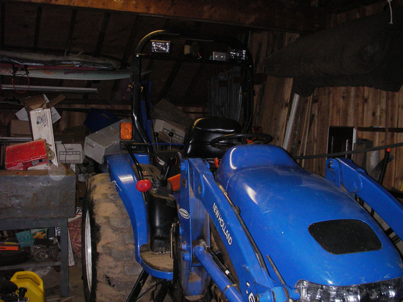

Hi All,
Just finished the installation of (3) 55 W lights that mount on a length of angle iron just under the ROPS. The lights were purchased at Autozone for $35 and the angle iron was lying around. The junction box, two push on switches, insulation landscape wire, inline fuse, and black spray paint were all under $20. There are two switches on that runs the 1 lights to the back and 1 switch were turns on the 2 lights in the front, then they have a common hot lead from the battery with an inline fuse. Check out the following pictures.
Thanks for all the previous installs and pictures, they definitely helped in the designed process.
-Geoff

My goodness nurseryman!
Are you sure you didn't totally comprimise the structural integrity of your ROPS by drilling two screws into it ;)
In all seriousness though... I was just wondering about a good way to mount a few worklights. I was planning to purchase a sunshade and mount on that but I'm going to push off my sunshade project for a while.
I'd prefer to not drill into mine but your general setup gave me a couple ideas. I never fold my ROPS down and there is a nice set of holes on the ROPS bracket that I think I could get a black metal pipe though and mount on that.

Band and 2-part squeeze calmps are good non detrimental rops mounting fixtures..e tc.
Just make sure your electrical system is up for the additional 14a load. i know some tractor charging systems are 'just barely adequate'.. etc.

Of course, those are no longer holes. Their structural material changes. :)
It seems to me that forces that would transition tangentially on the drilled hole still will, but those that would seek transition across the hole will still do this, except they move into the grade ? bolt. But I'm just guessing here; its early, my brain still thinks it is the land of dreams of knowing something.
I wouldn't drill without an engineering breakdown on this, but the setup is beautiful and exactly what I want.
