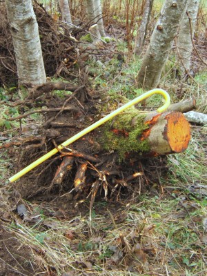

I've been cutting a trail through the bush at the back of my place to: a. get to the property line to fence and b. do some ditching to deal with a drainage problem.
The annual monsoon abated three or four days ago, the temperature fell to just below freezing and we have about 3 inches of frost in the ground. I decided to take advantage of this and pull stumps.
Attached is a picture of an average sized Alder with a stock cane for reference. This is my first real outing with the BL4690 on my B2710, and I'm really happy with it. I've asked it to do a lot, and it's performed well. I do, however, have some concerns about the stress I'm putting on the tractor. Any thoughts and/or suggestions would be welcome.

If you've progressed to the point where you're smooth on the controls, I don't think you'll damage the tractor. It's the banging and bucking bronco movements we all go through in learning to use back hoes that are hard on the machines. I'd say the back hoes are made for this kind of work. Hard work is ok, just so long as it's done smoothly.
I've got the smaller B4672A 'hoe on my B7610. My hard use is in digging up boulders in the not quite decomposed granite soil we have here in the Sierras. I follow the caution in the manual about not using the side of the bucket to move material around. Other than that just dig.

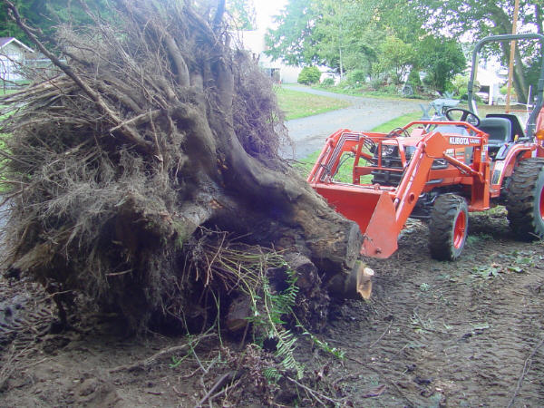

I have dug up a bunch of stumps with my B7500 with a 4672 BH. I have really pushed it and seen no signs of wear. I have replaced the bushing on the top link a few times, but that is all. It is a wearing part and should be replaced fairly regularly, otherwise it can mushroom and be difficult to remove. I have attached a pic on one of the stumps I've removed. People knock the 3pt BH, but it has done everything I've asked of it.

Wow! That's not a stump, Greg! That's a career! Well done!
