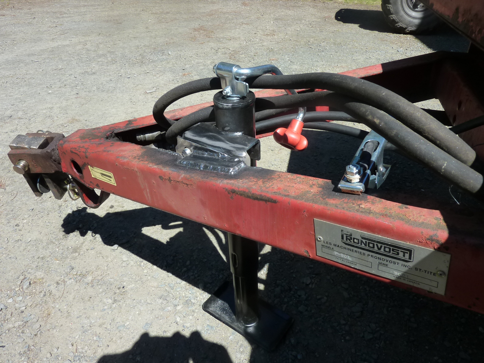

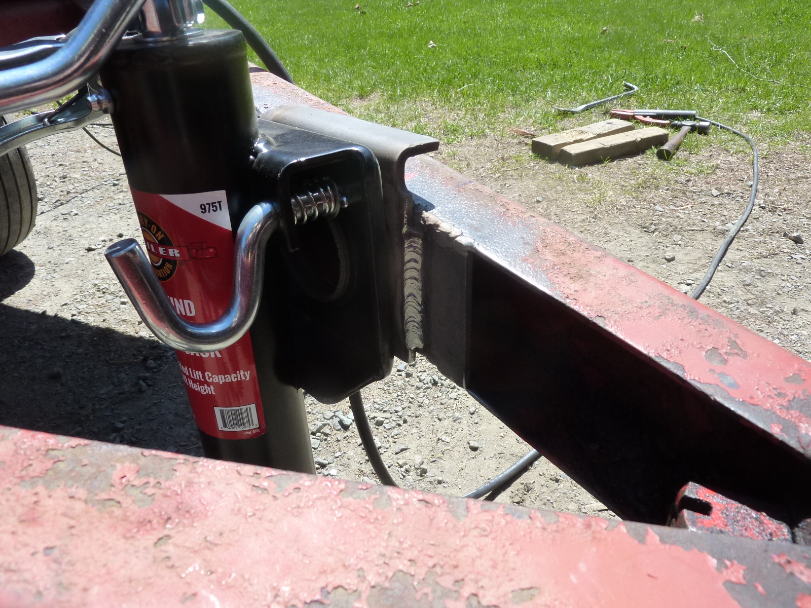

I have only had it a couple days now and already love it. I've been picking away on a dump trailer rehab lately. Yesterday I put this trailer jack on. The first actual job with the new welder so I figured I would post it. I wanted the fold-up jack on the inside so it wouldn't get rubbed by a tire in a tight turn. So I added a piece of 3/16 to the .140" channel to make a section of square tube to mount the jack on. You can see the trailer tongue is not horizontal it slants down hill. I cut the top weld flange of the jack off and welded in a new one.

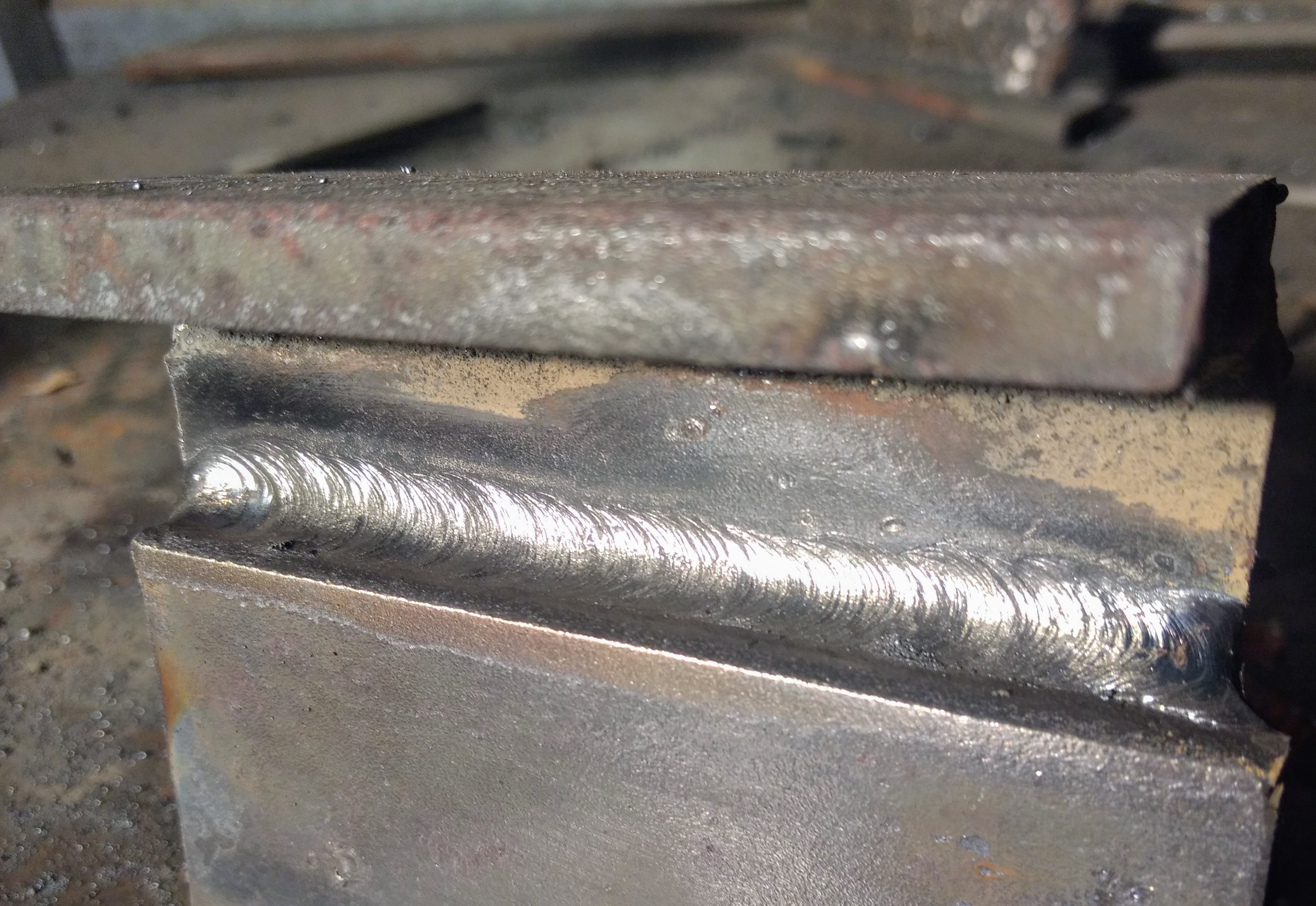

The PowerArc 200ST is a very impressive welder!:thumbsup: Mine will stack 6010 like my Lincoln SA-200s. It is also a dream to run 7018 with it too.

   / Liking My New EverLast PowerArc 200ST #4
I like how your jack handle now doubles as a hose guide!
   / Liking My New EverLast PowerArc 200ST #5
Looks pretty good. :thumbsup:
I don't know if it's necessary, but i usually give the spot for the ground clamp a quick shine with the grinder.
:laughing: Just holding the stowed end that plugs into the tractor out off the way for the photo. Maybe you were joking - sometimes it is hard to tell.
