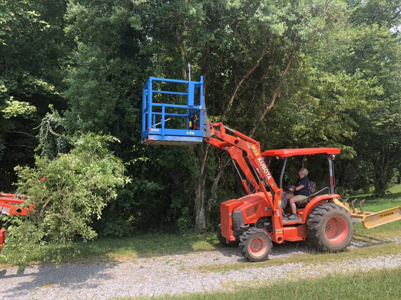

You like many of us face the same challenges of maintaining property. I have no experience with either machine but have considered them. Looking for reviews and talked to a local dealer. My hillside hazard from rollover from boom or side shift a concern.
Mowing around ponds and creeks I back the mowers to the edge. 4wd tractors make this more successful now. Too many times stuck by going sideways and can’t mow across water’s edge.
Miles of woods encroachment on roads and clearings use to involve a lot of manual chainsaw, polesaw, and tree pulling. Now mostly done with grapples, Intimdator and Piranha bar. With the wife’s help driving and me in a FEL basket can clear a road higher, wider and arguably better than a front mower. Pleasing landscaping important at times and places. Also handy for other uses.
Recent addition of hydraulic polesaw for the FEL let’s met tackle bigger higher limbs as well as the small stuff. Been keeping me busy this year.
Wish there was one implement that could do it all. These kind of attachments work best with HST. Reaching out magnifies the smallest moves. Being in the right position important. If you decide on either attachment hope you can post a review of your experience.
