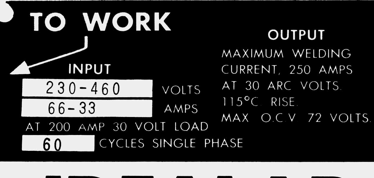

Not a 120 machine. H3 is for 460. It can be a common misconception that these machines are 3-phase because of the capability to run off 460. I got a great deal on one because the seller got it from a auto shop and when it wouldn't run on 230, he believed it was a 3 phase machine.
IdealArc Manual
