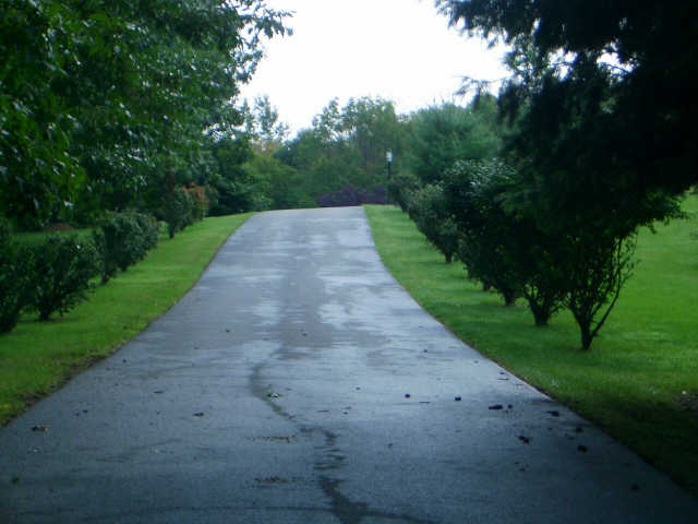

Looking for some educated opinions (are there any other kind? /forums/images/graemlins/wink.gif ).
I need to begin an ongoing grub, weed n' feed, etc., program for about 3-1/2ac. of established residential lawn. Originally eyeballing a 40gal 3-pt, 10' boom sprayer, but now I wonder if I'm better off using a broadcast spreader due to obstacles. Most lawn area is open, but there are plenty of areas that might pose problems for a sprayer (pic shows one). Equipment costs are about the same, but liquid sure sounds easier... cleaner, no heavy lifting, easy storage, etc. A quick search for liquid vs. granular application preference and price comparison didn't come up with much. Now I'm having a devil of a time trying to decide if liquid offers sufficient convenience to offset the obstacle hassle.
Any words of wisdom? Time to get moving on this, the grass is starting to grow!

dholly,
Use both. Granular around your obstacles, and liquid in your open areas. Try it once, and see what the results are. I have 3 acres of tall fescue here in northeastern Ohio. I've always used granular products. Mainly Scotts products. What brand of liquid product are wanting to use? I've never compared the cost difference between granular to liquid.

dholly,
There are advantages and disadvanteges to both methods. In short, spraying is better for weed control and granular is better for fertilization. Granular products need to be spread on a wet lawn for effective weed control.....but granular products feed the lawn slower than liquids and feed for a longer period of time. Spraying can be done on a dry lawn and more effectively kills weeds due to the fact that it covers the weeds better than the granulars...but spraying feeds quickly and does not feed over a period of time as granulars do. Your lawn will stay greener longer using granular.
Spraying does have one big advantage over granular. There are certain weeds that can not be controlled by granular products (wild onion is one I had a big problem with). There are very few that liquid products can't tackle. As far as price difference, I have found liquids to be much less expensive but that is going to depend on your supplier.
I personally use both methods, granular for feeding and spraying for weeds. If I had to choose one over the other I would go with liquid spraying. It's much easier to apply and work with. You can also add a dye to the mix which makes it real easy to apply.
Hope this sheds some light.
Jeff

Thnks for the Drive75 tip, hadn't found that mentioned in any of my searchs.
Jeff and arthurb - THIS THREAD contained good info re: liquid products and cost estimates. I've concluded the liquid weed control is where I'm going, so I'll also begin what seems to be a good liquid fert knowing I might not get as good, or as long-lasting, result. Too much lawn and not enough 'green' for the granular, if you get my drift. /forums/images/graemlins/wink.gif
Here's the equipment plan... $450 buys the Supreme 40gal Fimco spot sprayer on a trailer (about the same as the 3-pt model). I am simply going to make a platform to slip into the 2" reciever to use it on my existing 3-pt frame, and add a homemade 10' boom behind (I want the new trailer for a GenSet project I'm working on). Then, because running a large boom is going to be problematic in certain areas, I thought I'd also rig up a shorter 3 nozzle boom on front of the little JD GT275 lawn tractor ala beenthere's setup. I have a pull behind lawn cart I can simply set the tank in already to tow it behind. If I do this right, I might actually get FOUR birds with one stone. /forums/images/graemlins/grin.gif
