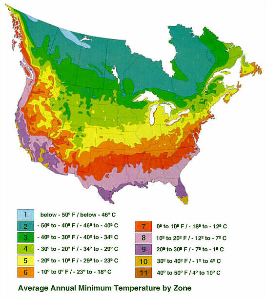

Addendum: If it really is cold related, then it makes more sense doing this by Temperate Zones. Attached (next post) the NA low-temperature zones. I am in Zone 6.

North American Temperate Zones

Del; The answer may lie in building a table, with the number of respondents in each temperate zone responding 'UDT Dealer' or 'Super-UDT dealer'. So far the responses look like this:
Zone | UDT | Super-UDT
1
2
3
4......|........| 1
5......|2......|
6......|1......|
7
8
9
10
11
Since MO and PA are split between Zones 5 & 6, but mostly 5, I put them down as 5's.

Just to put this thing to rest, I am going to venture out on a limb. In addition to the above postings, I received a couple of off-line responses. Now, the sample size is very, very small (we didn't get close to the 200 that Del was looking for). Not enough for a non-parametric test, much less than enough to satisfy parametric sampling requirements.
Value-add of Super-UDT is for extreme cold weather climates. A northern US dealer confirmed this offline. Let me say, this makes sense to me. Kubota Corporation is warranting the equipment. If there was some other issue, I really don't believe that they would allow the dealers in warmer climates to use UDT instead. They receive the orders; they know what the dealers are stocking.
Warm and fuzzy part of the analysis: Super-UDT has no advantages in Cold Temperate Zones 5 through 11 (Andy - you have to scroll down the map to see the zone numbers). Super-UDT performs better for the colder temperatures for Zones 1 through 3. Zones 4 and 5 seem to be a toss-up.
