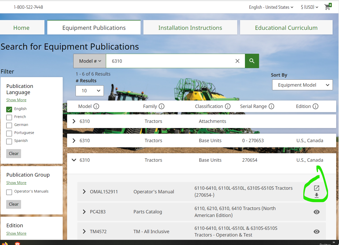

Ditto on removing dust from hyd breakaway couplers before attaching male tips. My next suggestion would be to read 6310 operators manual. If tractor owner doesn't have an operators manual one can be downloaded/viewed for free at following link.https://techpubs.deere.com/en-US/Search/Equipment.
