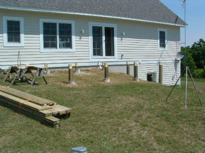

Two years after we moved in, I finally am getting around to building a deck in back of the house. Alas, I didn't get to use the tractor to dig the pier holes - I don't own a 3 pt auger. The rental guys wanted about $200 for an auger-equipped Bobcat, so I dug them by hand, 12 inch diameter and 42 inches down. I told my wife that I should get the $200 we saved to put in my tractor fund, and she agreed!

Got the concrete poured and the posts in over the next two days... still no tractor work.

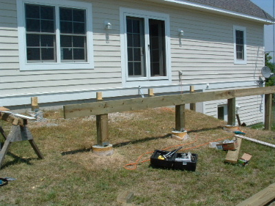

Next came the beams ... still no tractor work. /forums/images/graemlins/frown.gif /forums/images/graemlins/frown.gif

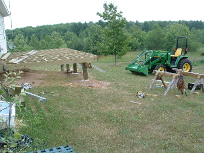

Finally, yesterday and part of today, I got all the joists nailed together, but I assembled the whole thing two feet away from the house so I would have some hammer swinging room to nail into the ends of the joists. So, when I got it all together, squared up, and braced, I ... ta-da! ... used the tractor to push the whole thing across the beams and up almost against the side of the house. I was pretty stoked. It worked like a charm.

Nice looking project, and glad you found a use for the Deere.

Tom,
Did you use the sonotube all the way down the hole for your footings. I always thought that those were used above ground or in an excavation area, and that if you had a tight hole they weren't needed. But that's just me thinking out loud, as I have yet to use them. Great looking deck! and great idea about leaving the extra room for the hammer.
   / Little Deck Project
</font><font color="blue" class="small">( Tom,
Did you use the sonotube all the way down the hole for your footings. I always thought that those were used above ground or in an excavation area, and that if you had a tight hole they weren't needed. )</font>
I did use them all the way down. I thought it would be easier than trying to dig just the right diameter hole for a snug fit on the tube and then building bracing for the short section of tube that would stick out of the ground. I looked at my county's recommendations for deck building, and they showed the piers sticking out of the ground a bit, so I figured I'd better do it that way. I believe it's to keep the bottom of the post and the bracket as dry as possible.
Tom

TM - I'm working on my deck right now too. Why did you use a beam so close to the house? I just used a ledger board bolted to the rim joist on the house. I then only needed one beam 13 ' from the house, it sets on 6x6 posts.
