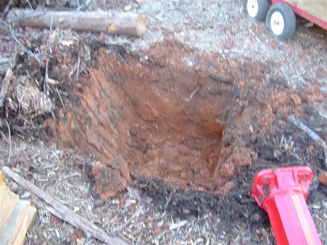

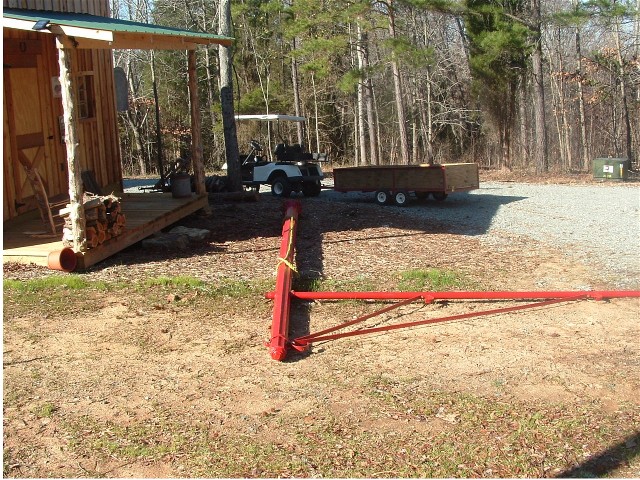

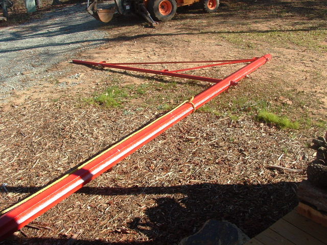

Here is a little project I'm working on.I picked up an old service station signpost from an old American Gas station that we ran when I was a teenager. My dad farmed, built houses, was a loom fixer in a local cotton mill, and he opened a gas station, and this signpost came from it. I took it down, wire brushed it, And primed and painted it. Vickie wanted it to go at the tractor shed/store building.
#1 is the post laying on the ground, notice my rigging?
#2 is the golf cart hooked to the trailer to haul off the excess dirt, my son has my dump trailer
#3 I'm ready to dig the footing

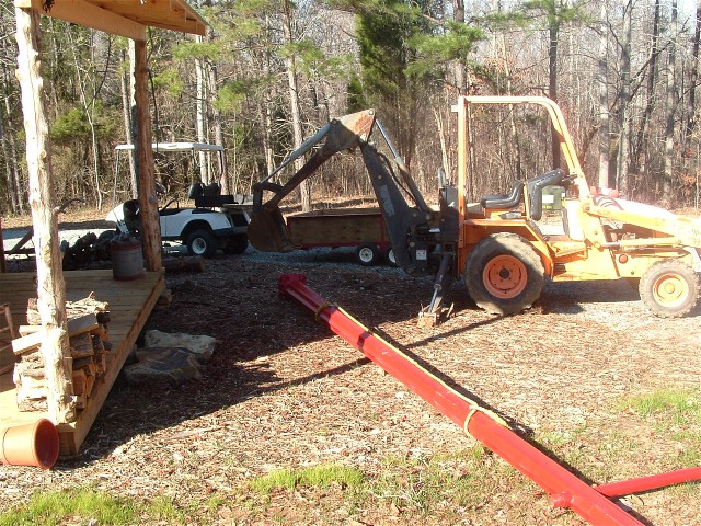

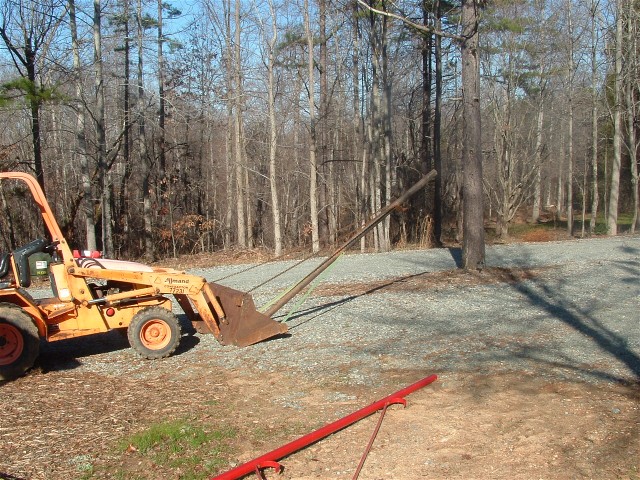

#4 is the boom pole on the FEL to get the post high enough as it's 20' tall and the arm sticks out 12'
#5 is a fuzzy pic of the hole which is 3'x3'x 2' deep

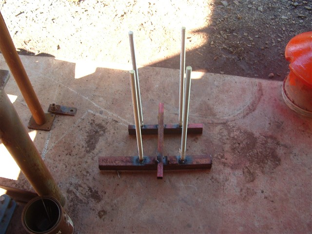

#6 is the anchor bolts. I used some scrap steel out of my scrap bucket to form an H then welded the anchor bolts to it. The anchor bolts are 3/4" X 24" threaded rod.
I poured the concrete and sat the anchors , now I need to wait for it to cure.

Are you sure that hole is going to be big enough to support that? I would hate to see your hard work go to waste (post falling over and tearing up your future sign). How big was the sign, kind of hard to tell from where hardware was to hang it? Until you find an original to restore, could you make one out of plywood and paint and varnish? Maybe some thin sheetmetal?
   / LITTLE PROJECT
I'm not an engineer, so can't show figures to back it up, but I put 2,000 pounds of concrete in the hole and the post weighs around 250 pounds, so I just used the "SWAG" method. Sicientific Wild Assed Guess, for anyone that doesn't know what a SWAG is.
I have looked at some origionals, and the owners are very proud of them. I expect that I'll make a sheet metal sign and Vickie will paint it.
I haven"t set the post yet, I wanted to give the base a couple weeks to cure first, maybe this weekend. later, Nat
