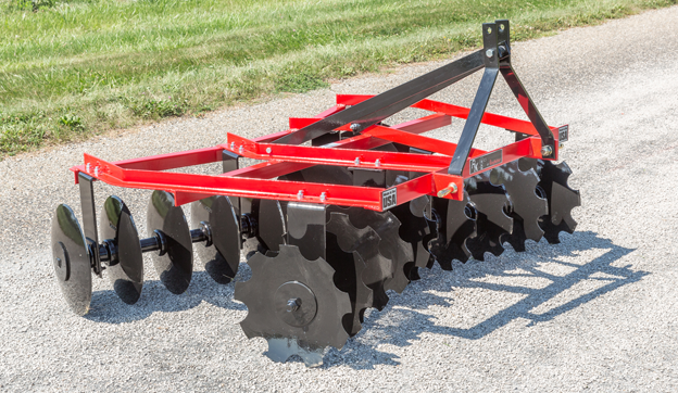

If a PTO driven tiller for the size you need would not work, then on those existing tilled gardens, snag a compact tractor notched disc harrow.
