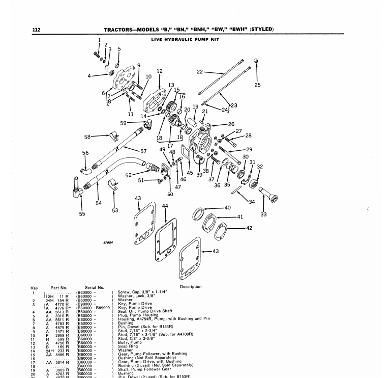

I have a 1949 John Deere model BW tractor, using a live hyudraulic pump mounted between the governor and the magneto. The pump operates a 45W loader and a Charlyn power steering unit. The pump has stopped working, which renders the tractor useless. (can't lift the bucket, can't steer the tractor) Can anyone steer me to a repair shop that can service (rebuild) this pump?

Can you post a couple of photos so the details of the power steering are more apparent.
True hydrostatic system or a steering assist system.
Did the pump stop working suddenly? where does the pump suck its oil from. Often suction screens gradually plug up and finally one day do not allow anything through.
Rebuilding old pumps is not often done. A new one will be proven solution. Of course finding one can be the challenge.
Is the pump driven by a gear from the front of the engine?
I would rather take a little time to confirm your diagnosis that the existing pump is bad.

   / Live Hydraulic pump - John Deere BW - repair service? #3
Here's the parts schematic for the live hyd pump. I didn't locate a sump screen & I doubt tractor of that era had a screen. I suggest to yoke(key 31) & shifter pin(key 46)

Jim,
Thank you again. I was able to download the schematic and print it out. It should prove very useful.
