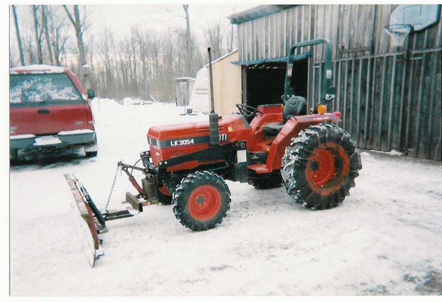

Here is a picture of my tractor with a 7' snow plow i redesigned it was off of a ford dexta that i traded in for my lk3054.The plow was 30" tall,i cut it down to 22"tall made a mounting frame on the front of the tractor that the loader sub frame helps reenforce.I also made up the new push frame for the plow ,had to buy two new "shorter"trips prings.The front frame mount is left on when i am done with plow, remove four bolts and all the plow rigging comes off.(cylinder,lift arm,plow).
