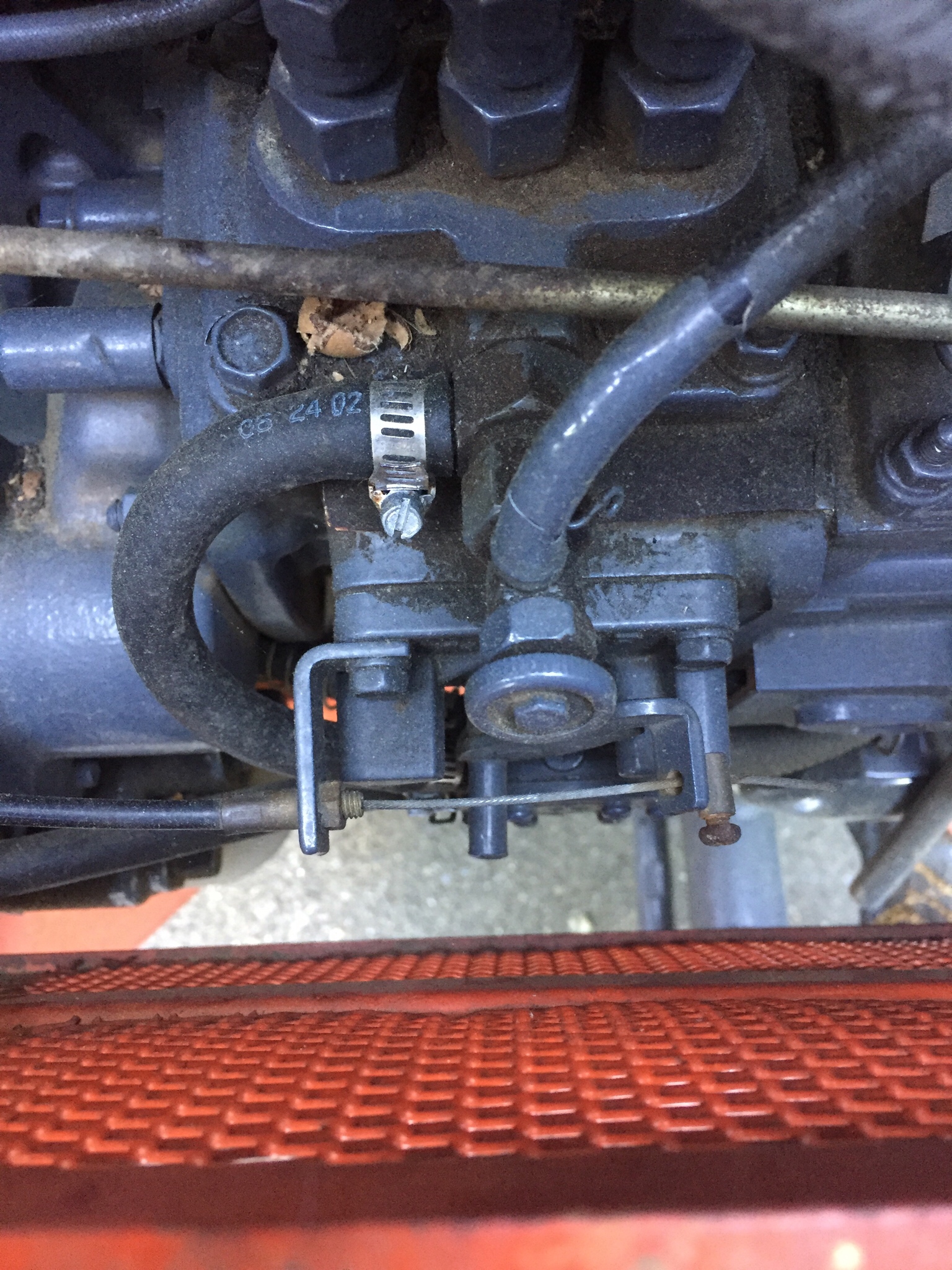

   / lk3054xs Replaced fuel filter and can't start tractor
Can you tell me what this valve does?
