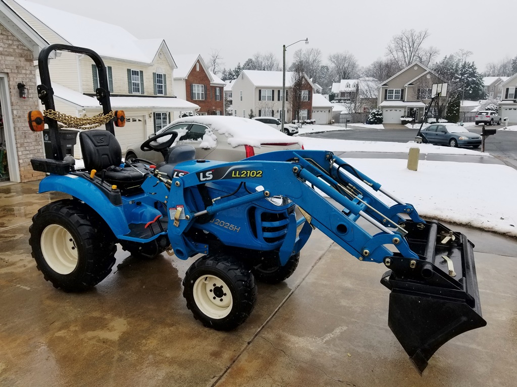

Dec 28, 2017 / LL2101 vs LL2102 #6 CMV Platinum Member Joined May 10, 2015 Messages 877 Location NC Tractor Kioti NX4510HST (previous LS XJ2025H, JD 500C) Mine came with the 2102 and the bucket in picture.
Dec 28, 2017 / LL2101 vs LL2102 #7 T tomplum Elite Member Joined Jan 30, 2017 Messages 2,798 Location PNW Tractor XJ2025H I think that the answer is no quick attach. I seem to remember when shopping for ours a year ago to be certain to watch for that.
