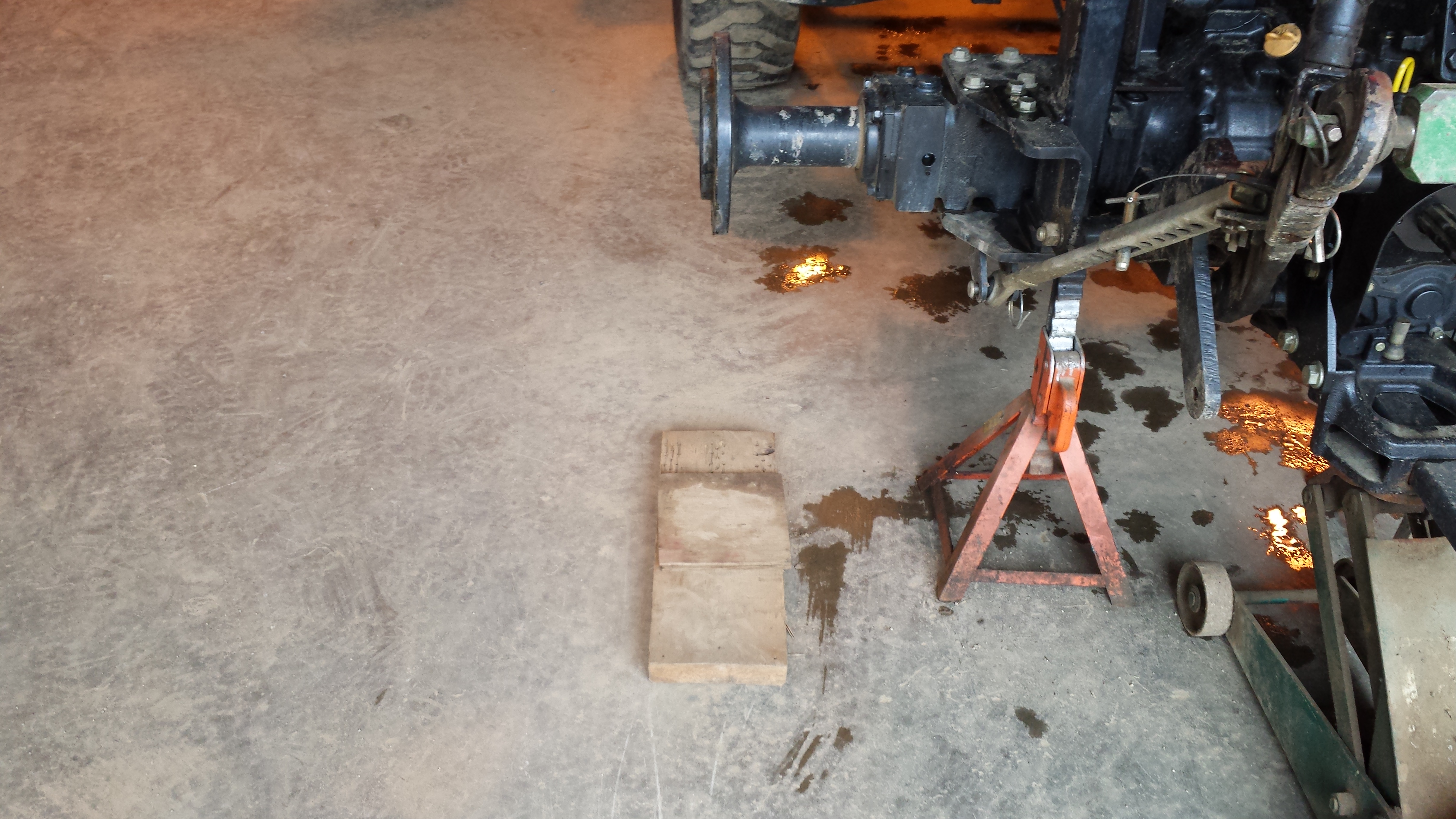

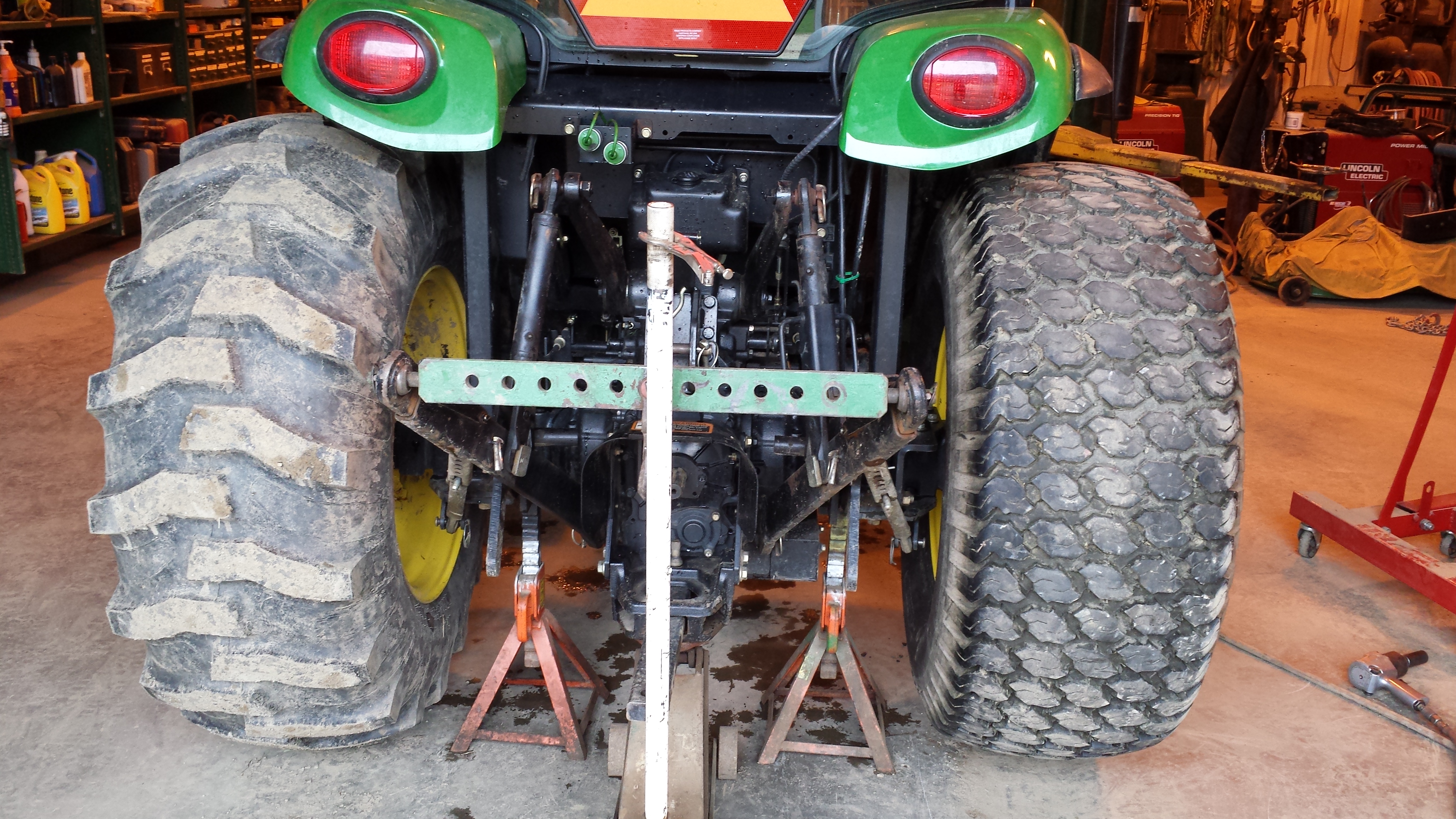

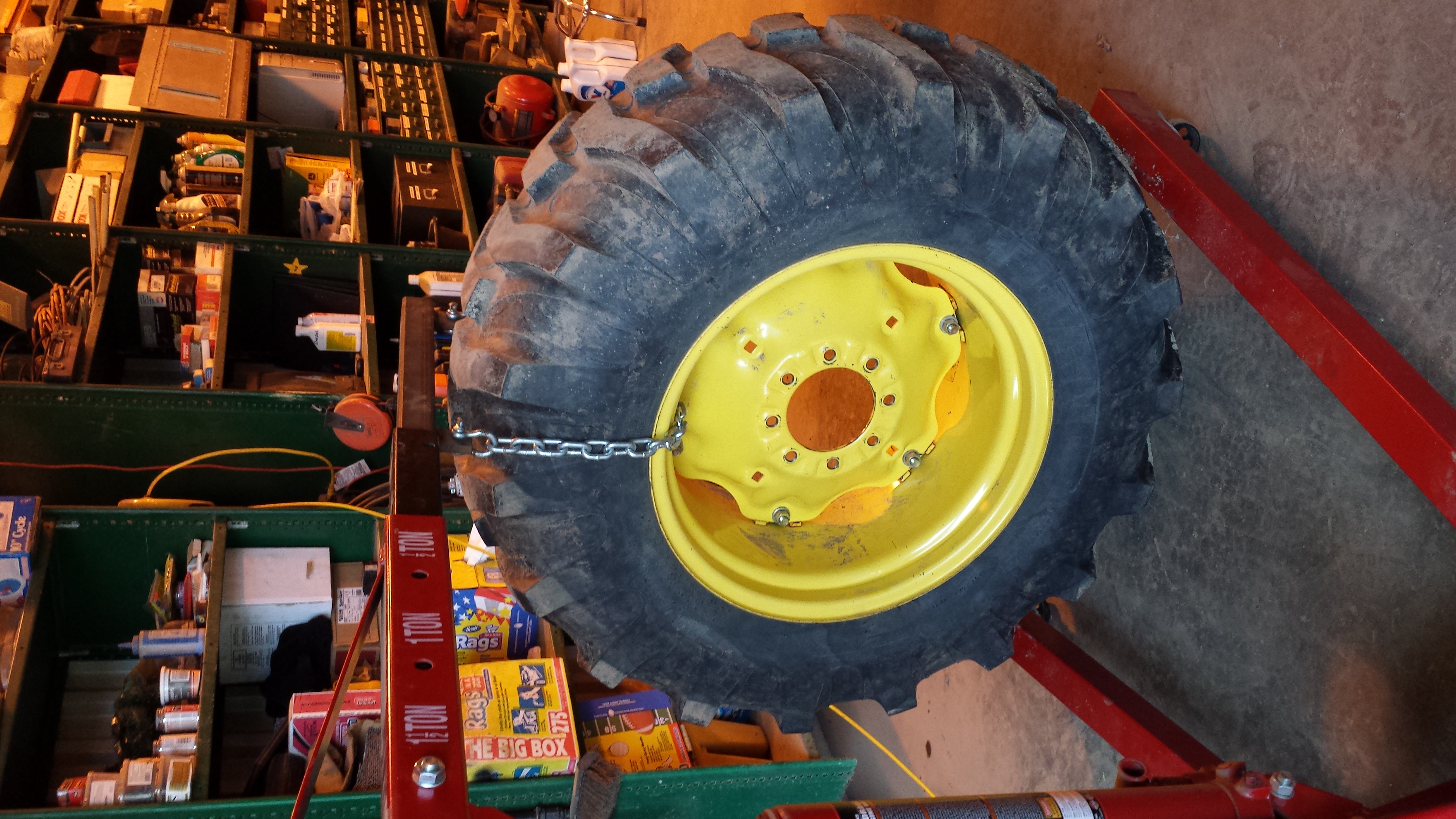

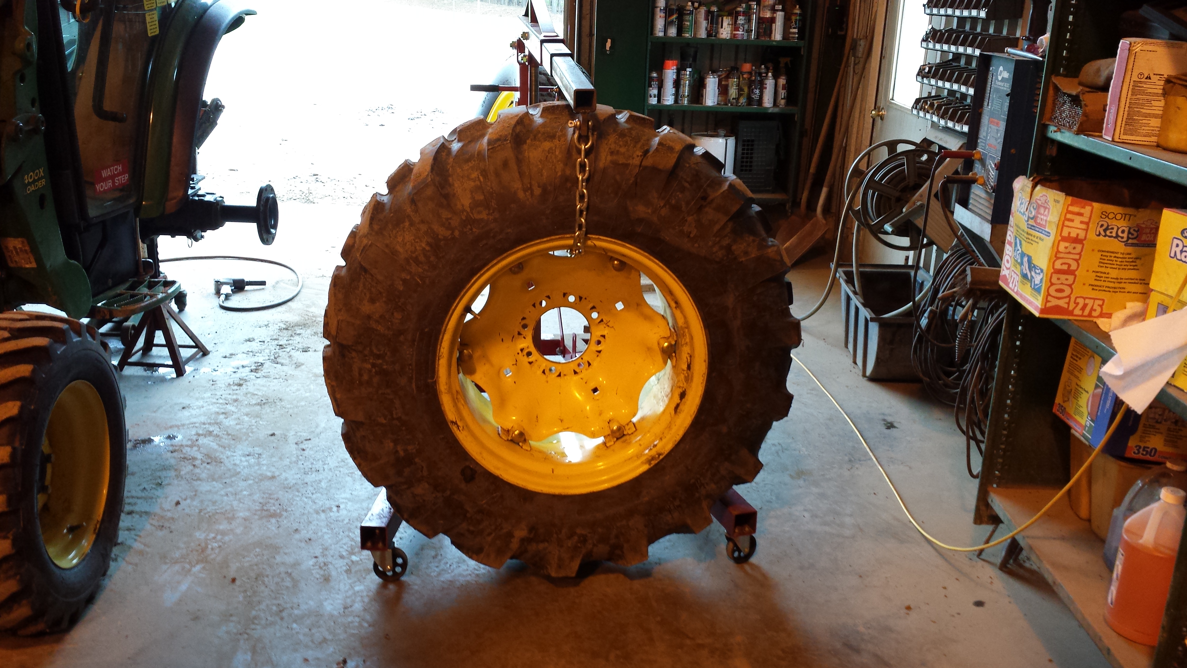

This maybe a bit more than you want but the attached pics show 20140507_113819.jpg how I do it. I have since added wheel weights. Tire and rim 150# rim guard 550# wheel weights 210# Loaded tire est 910#. Maybe you could borrow a friends engine lifter. You would need to make a lifter bar and chain asmy. I have since modified the lower support arms for additional wheel clearance. I change my wheels bar to turf and turf to bar each spring and fall. My biggest concern was always dropping the wheel and have it act like a coin and wobble around and possibly hurt me and or knock the tractor off the jacks. Later.20140507_113757.jpg20140507_114358.jpg20140507_112727.jpg

This maybe a bit more than you want but the attached pics showView attachment 565896 how I do it. I have since added wheel weights. Tire and rim 150# rim guard 550# wheel weights 210# Loaded tire est 910#. Maybe you could borrow a friends engine lifter. You would need to make a lifter bar and chain asmy. I have since modified the lower support arms for additional wheel clearance. I change my wheels bar to turf and turf to bar each spring and fall. My biggest concern was always dropping the wheel and have it act like a coin and wobble around and possibly hurt me and or knock the tractor off the jacks. Later.View attachment 565893View attachment 565894View attachment 565895
Thanks for the pics. I have an engine hoist and thought about going that route but I don't have enough room between the cab/fender and the tire to get the top arm through to reach the back. I thought about making kind of an "L" shaped arm that could sit in the hook of the engine hoist and grab the rim from the inside top but not sure it will be stable enough and keep the position well enough to reinstall the tire.
