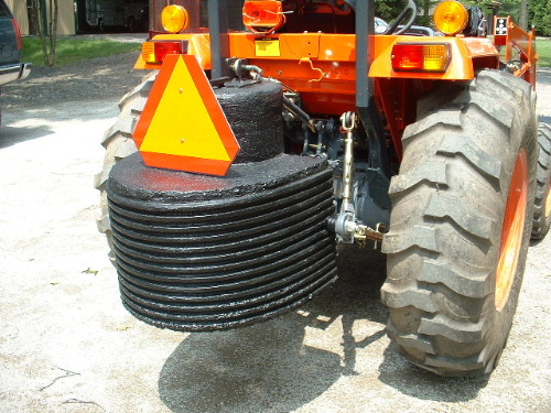

Dave an alternative might be a counter weight or ballast(see photo).
I built it for under $100 but,I still might load the tires when I use the 3pt. more.
For now I'm doing mostly loader work so if I get a flat it's an easy fix,relatively speaking.
Does anyone know just how many pounds I could expect to get with the 24x14.9 rears loaded?.........Mike

   / Loaded tires #9
If you filled a 24-14.9 tire 75% full with water you would be adding 47 gallons which equals 392#. Different solutions vary a little in weight. So you would be adding somewhere in the neighborhood of 750# - 800# to the rear of your tractor.

   / Loaded tires #12
Bill,Thanks for doing the math.800 pounds would be just right,same as my ballast.........Mike
