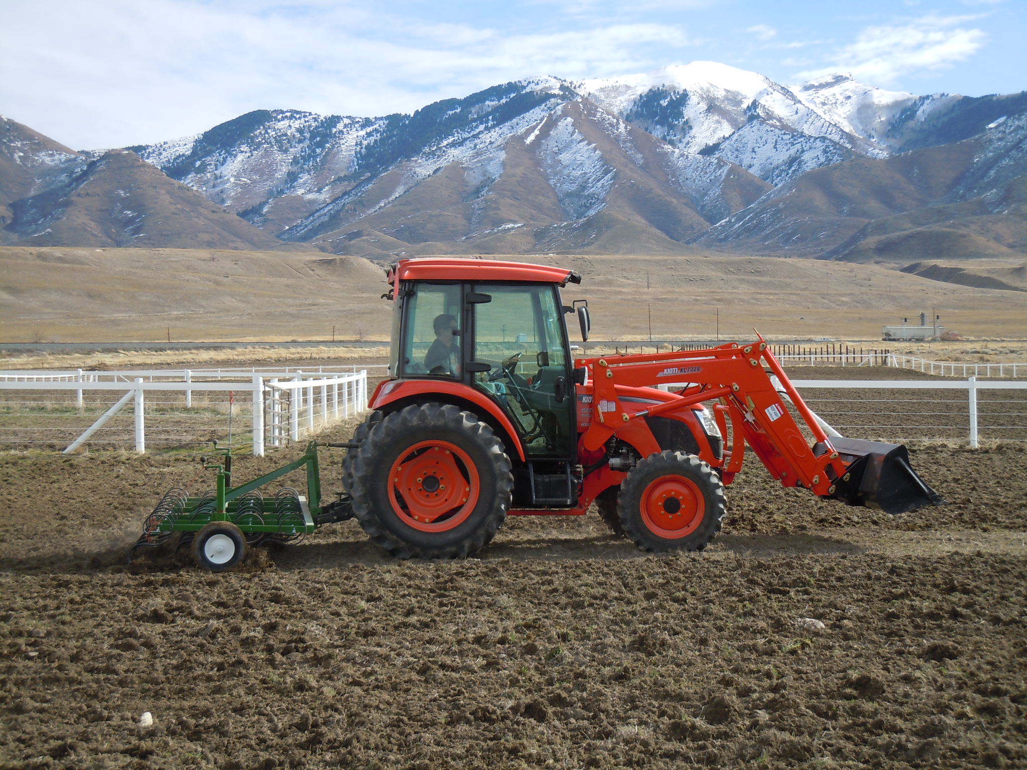

I have a question about loading the tires on my tractor. I understand the benefit for loader purposes; my question is will the tractor act differently at higher speeds like moving from one field to another, and will it be more or less stable turning while going at higher speeds?
Thanks I look forward to the replies.

unless your tractor will do 50 mph you won't know the difference
   / Loaded tires #3
It does ride worse, but it is well worth the downside.
