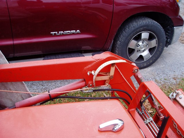

I have an older L3650 with a LA650 loader that I like to have some type of a levelling aid so I know when my bucket is level. I was wondering if anyone has made or has an idea for this.

Here's a mechanism that I built for my LA302. The link to the bucket rotates the Curved piece to indicate level.
The middle indicator is linked to the loader frame to indicate level at the current height.
The outer indicator is fixed to indicate level when all the way down.
It takes a bit of tinkering to get everything right, but once it is set it works very well.
That is a neat setup. Looks like you have 2 pointers and a rod heading toward the back of the tractor. That for when the bucket is in the air? I'd like to see more on how things are attached. Thanks!
   / Loader bucket levelling aid #6
Kinda difficult to get a much better picture of it because the tractor is in the way.
The link going toward the rear attaches to the fixed loader frame and moves the middle pointer. That pointer indicates the bucket angle at the current loader height. The outer pointer is fixed to the lift frame and indicates the angle when the loader is at ground level. When the loader is at ground level the two pointers will line up.
