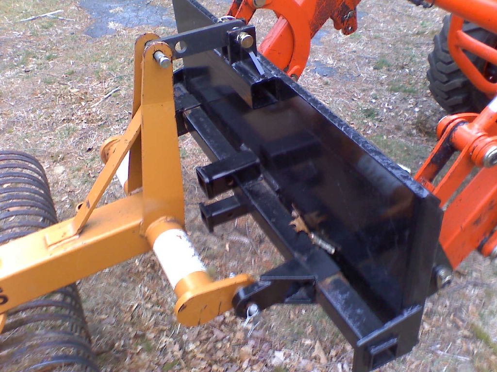

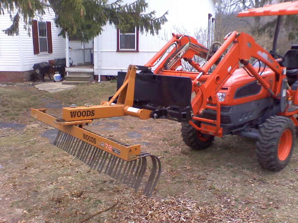

Or, a new implement....this is what happened the last time I "stopped by". Actually I used this FEL 3PT mount today while cleaning up after felling some big trees and after planting some new apple trees. It came in very handy. A rake mounted on the FEL is much more precise and easier to control. I wouldn't rake a field like this but for landscaping and clean up it is great. Unlike a bucket, you can see right through it and also adjust the tilt to modify how aggressive a bite you want on the fly. Very handy.
So, the moral of the story is that you just never know what you will take home with you after a visit to Rick Wallace. But, bring a large vehicle...IXLR8 had to pass on this device as his car was already full. :D

Does your FEL 3PT attach directly with the standard pins for a bucket or do you have a quick attach adapter? Who manufactures the FEL 3PT. It looks very usefull.

Quick attach. It is useful and so far I use it primarily with the rake. The other potential use would be a quick snow plow by using it with a rear pivoting blade. I cannot see using it with a box blade, plow, or many other ground engaging 3pt attachments. It also has class 2 and 3 receiver hitches built in so that comes in handy for moving trailers etc. A removable boom pole could easily be attached via the class 3 hitch. I'm thinking the class 2 hitch could hold an fishing pole too.
