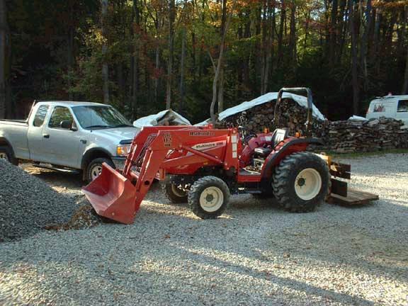

3510 /forums/images/graemlins/grin.gif
If you want a loader, this is a loader. Its a LOT of loader for a tractor. FYI, LOAD YOUR TIRES /forums/images/graemlins/grin.gif
The 3510 is gear, syncro with shuttle shift, I think it is on the same frame as the 4110. The 3510 hst is on a smaller frame 2815hst??
